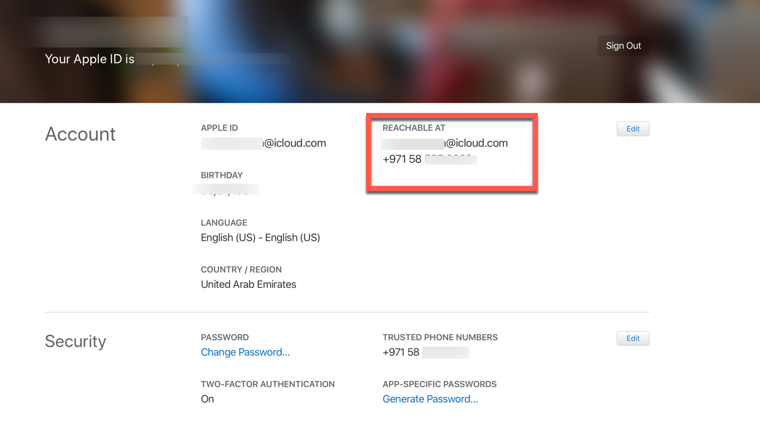

when you sign in to apple ID site, there are two main columns:
at left there is apple ID and on the right is reachable at
on the right side (the reachable at) click edit and make sure you have clicked your email address to be able to reached at.
This is what it shows:
it does look like it should be no problem.
