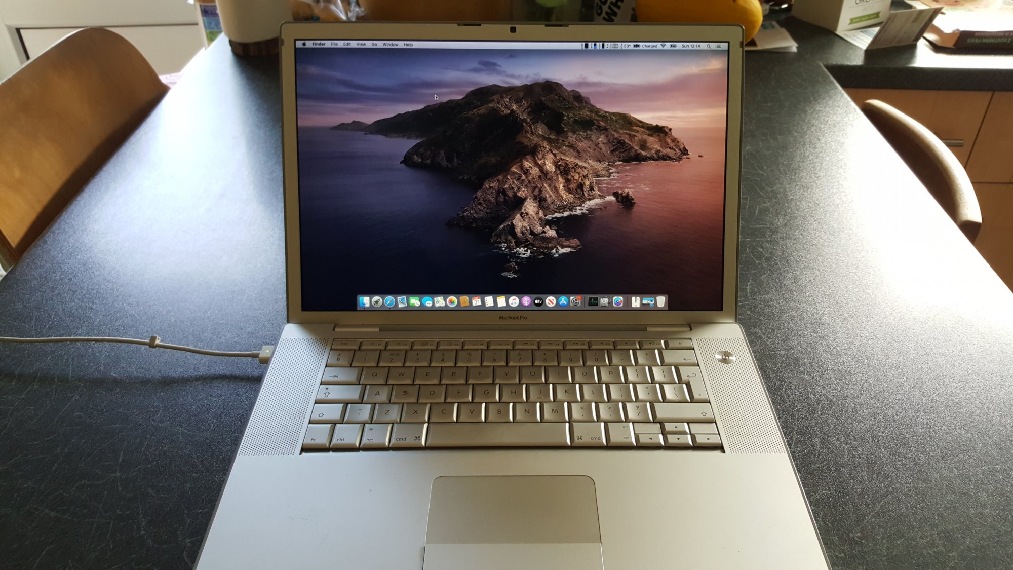

Recently refurbished a 2008 MBP 4,1 and added a SSD. Thought I'd try @dosdude1 Catalina patcher which looks like it should work. Followed the process on the video and get to the part where it reboots and should go to a black screen with verbose output displayed to continue the installation - only it doesn't. The screen switches to black briefly and then drops back to mac OS Utilities again, apparently abandoning the installation. Has anyone else got this to work on one of these models?

Thanks everyone - eventually got it to work.
From what I can work out, what was happening was that when the first phase of installation was done and the machine rebooted, it didn't see the new installation partition as a valid boot drive so booted off the USB drive again, leading back to the macOS utilities.
So when it was rebooting after the first phase, I pulled the USB drive, forcing it to continue from the ssd. What appeared to be a normal installation then took place (and took maybe 40 mins) and it then rebooted again, at which point I re-inserted the USB drive and booted from that to do a post-install of the patches. When that finished, it rebooted again, taking forever ( 15 mins maybe) but did then complete the setup as normal. Once Catalina was up and running, the Update Patcher utility showed an update was available, which I installed.
At first, the cpu was pegged at 80% with nothing running but after another 15 mins it settled down (Spotlight indexing no doubt) to 82% free. At Idle with nothing running it's around 15% cpu, 2Gb ram and 52 degrees C. The only thing I've found so far to not work is the back lit keyboard. Anyone know of a fix?
Many thanks to @dosdude1 and the other contributors for their amazing work 👍😁

Thanks @bobesch I'll give it a go. For info, I haven't tweaked anything on this installation and I'm staggered at how well it works. The MBP is idling today at 94% cpu free and 38C (thank you istat menus). Not stressed at all by Catalina. 😁👍
