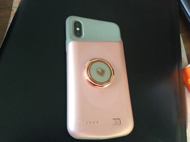

I bought a battery charging case. Heavy which is why I have the finger ring but I love how that if my battery runs down I never have to look for a cable or outlet. I just press the button. I plug it up at night and it charges both while I am sleeping.
