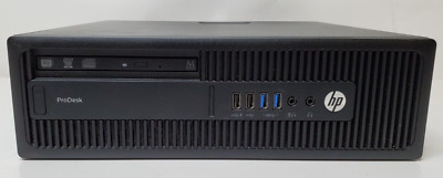

A. Windows NAS: (or Linux NAS)
A HP Prodesk 600G2 SFF is a nice item to have. It can accommodate 2 x 3.5" HDD easily.
Cheap one won't have HDD and OS: 20$ to start bidding (normally you can get one at the starting price)
Expensive one (90$) has SSD and Windows 10 pre-installed.
https://www.ebay.com/itm/195449063636

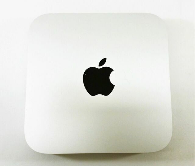

B. Mac NAS
The above 2 HDDs plus a 2 bay USB 3.0 enclosure with RAID function maybe the easy thing to set-up and runs. Plug it in your Mac Studio and make some configuration with the Mac OS to turn it to a NAS.
If you are afraid that it will use some CPU power, then add a Mac mini 2014(60$).
