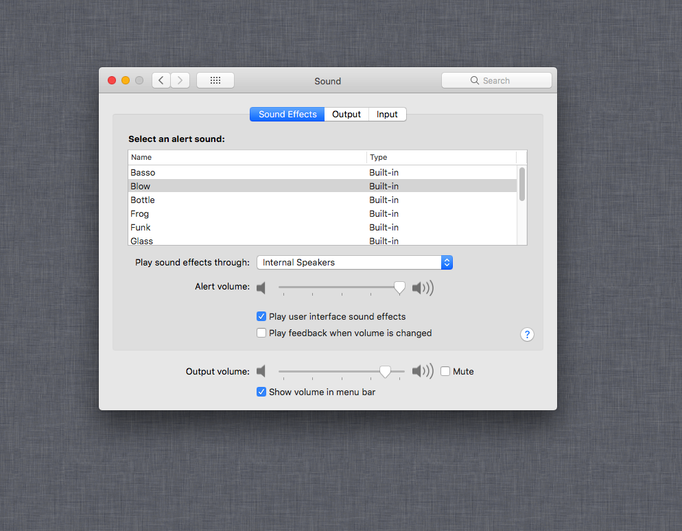

I may be mistaken but are you running High Sierra? I remember resetting my PRAM used to make the BONG volume up pretty loud and it would stay LOUD until you re-set the volume in System Preferences. But since I upgraded to High Sierra when I reset PRAM the loud BONG only happens once then on subsequent boots the volume goes back down to what it was set before the PRAM reset.
This is how you control the volume of your BONG sound..... (not very intuitive on Apples part)
System Preferences - Sound- Sound Effects.
Move the slider up and you will have your loud BONG back.
Yes, and make sure the output is the internal speaker, but not something else.
Jesus, Dr.Stealth, you are the man!
It worked!!
I am running Lion and Snow leopard, but this resolves the 'issue'.
Thank you, I am not worried anymore hahah.

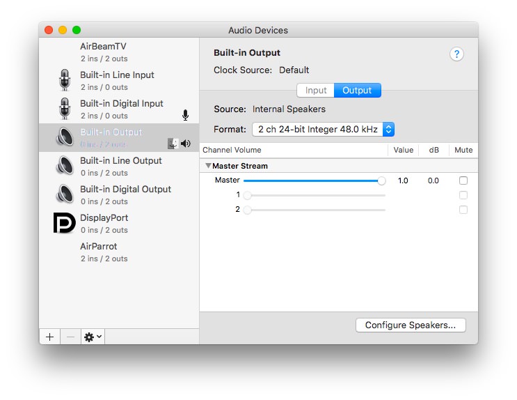

I think you said "it does not change with the volume control", and it does now?
Yes, exactly - that's what I said.
But my interface sound effects were at the lowest.
WhenI put them to the max it didnt work with the jack cable to my stereo, but when I unplugged it, it worked with the internal speaker - the chime is loud when the volume of interface sound effects is on max.
So the volume keyboard control does not affect the chime.
Yes, exactly.
I see. I though you tried to change the internal speaker's volume, but it didn't change the chime's volume. Yes, the start up chime's volume is sync with the internal speaker's volume, not anything else, because the chime will only output from the internal speaker. If you select any other output in the OS, the keyboard controls the selected output source, but not the internal speaker. You can temporarily change the output to internal speaker, adjust the volume accordingly. Or open Audio MIDI setup in Applications -> Utilities, and adjust the internal speaker's volume at there (no need to make it as the default output. Just slide it up or down as you wish).
