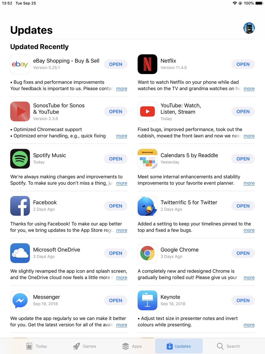

There is. iOS App update was released today. I’m in the Middle East but, being British my App Store is tied to the UK. I don’t have it on my X but do on my IPP 10.5
The Netflix update didn’t help.
App updates won’ t help. It is a structural problem, that needs to be addressed by an IOS update.
