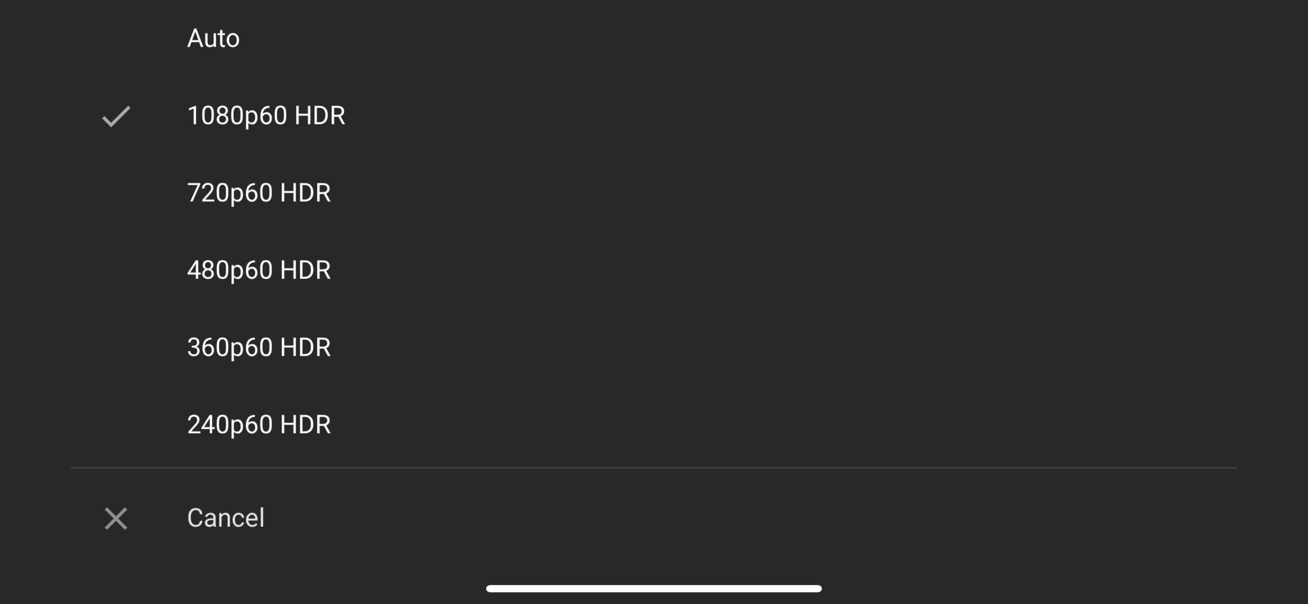

People, thanks ! But could you all read the thread before posting? The fact that YouTube now has hdr on iPhone XS has been posted several times now in this thread, so please let us get back to the issue of stuttering in Netflix and iTunes .

I haven't had any stuttering issues watching HDR 1080 60fps on the YouTube app since the new version came out. Still having issues on Netflix, just terrible.
Since youtube works, I would assume this is could be an issue with the Netflix app? Best case scenario would be they fix it in a new release of the app OR a fix at the OS level.
