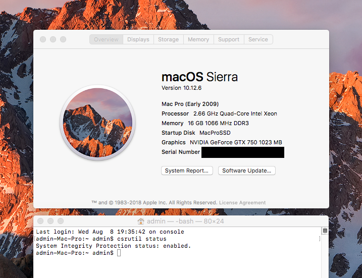

Apologies if this has already been posted.
I was able to do a clean non-modified install of OSX Sierra using a Mid 2011 MacMini (Macmini5,2) as an install host, setup an admin user and remote access, then take the SATA SSD out of the Mini and put it straight into a cMacPro (2009) 4,1
I had a dead graphics card in the Mac Pro (the original one) I was able to install the matching Nvidia drivers, and put an old PC graphics card in - and it worked!
I know there are more complex instructions about patching later OSX Installs for cMP's (and flashing firmware), but ... I didn't seem to need them? What should I test for - Final Cut X boots up, I have not tried much else. WiFi does not work - I expected that, I'm not sure what I am going to do with it.
I did not need to disable SIP - which is handy, as I would have been doing it blindfold (non EFI gfx card).
Safari feels snappier. Your thoughts are welcome.

Fair enough - it seemed the easiest without having a working display though. I'm surprised it worked, the MacMini and MacPro are quite different, and there is 2 years between them.
You're thinking like Windows installs. macOS install all drivers needed for all Macs that are supported by that macOS version, so you can install on a mini and boot on a Mac Pro, iMac, etc.
You can actually use this method with any supported Mac. A macOS install isn't really customized to hardware at all. So no matter what mac you use to install it, the resulting macOS partition is the same. That's why the method you used worked.
The only thing preventing Sierra and High Sierra (and now Mojave) from installing on the 4,1 is that the installer checks the model identifier and won't allow it to proceed on a 4,1. As you have seen, the OS actually runs just fine.
As already mentioned, the firmware update method is preferable since you don't have to jump through any hoops to keep running the newest releases. But you're correct in that you won't be able to do that without an EFI GPU (either buy a used stock card--GT 120 or 5770/5780 on ebay or buy a GTX 680 or 7950/7970 and flash the EFI firmware yourself.
