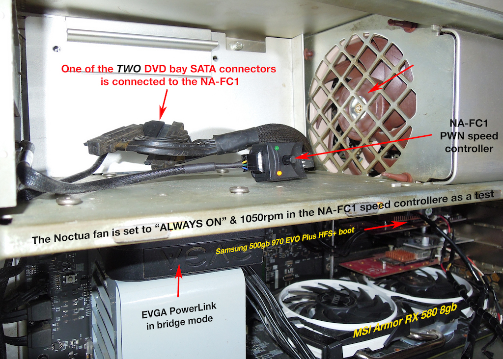

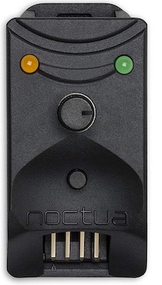

I have replaced my cMP 4,1>5,1 Apple standard 120mm PSU fan with the Noctua NF A12x25 120mm PWN fan and have also installed The Noctua NF-FC1 PWN Fan speed controller. I am happy to report that both the Noctua fan and the fan speed controller are working perfectly.

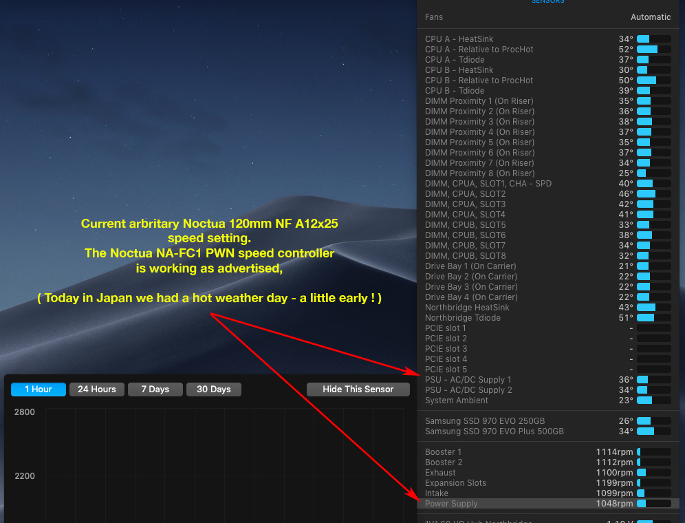

EDIT : I cleaned up the cables ! Everything is working. The Noctua fan is now at 1050 RPM as a test for summer
temps. It is working silently. @ 1050 rpm with ambient @ 26°C in iStats menus the PSU temp is 36°C.
Both of the DVD drive doors are taped OPEN to allow more airflow.

I have tested changing the 120mm Noctua NF A12x25 fan's speeds from ( EDIT ) 800 ~ 1,200 rpm using the Noctua NA-FC1. Response in changing RPM is near instantaneous

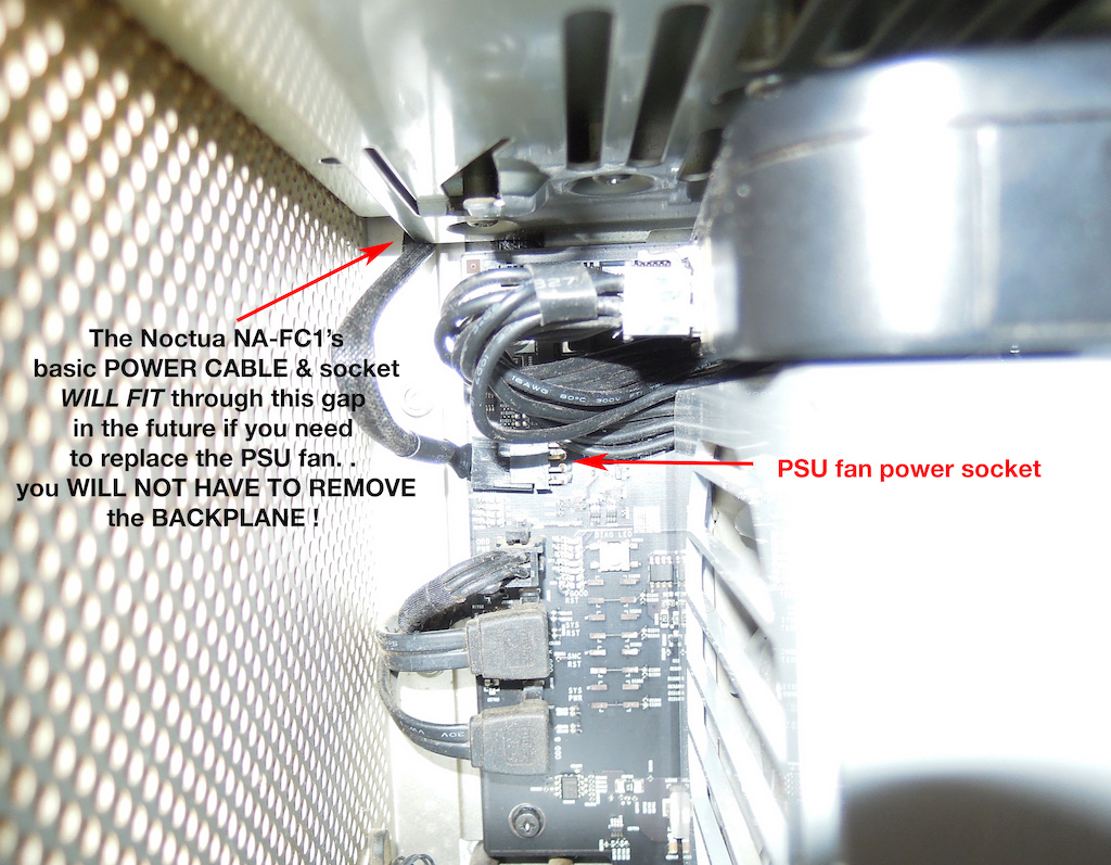

b. Why is the PSU fan's cable routed UNDER the backplane/motherboard ?
Apple decided that to remove/replace the 4,1/5,1 PSU fan the the backplane MUST be removed.
This is a fallacy, I ran the Noctua’s power cable down through the small gap on the far left side under the DVD/PSU area.
Problem solved though for the very first time/replacement the BACKPLANE/MOTHERBOARD still needs to be removed ; allow the cable re-routing.

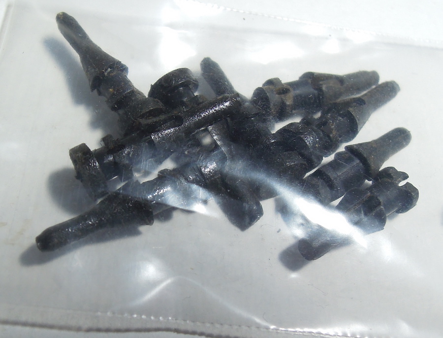

c. Fan rubber retaining grommets removal.
These grommets CAN be removed fairly easily.
Requirements : TWO pairs of slim long, ‘needle nose’ pliers
Using the pliers, grab EACH opposite end of a grommet and then STRETCH it from both ends !
Result: The grommet, as it is stretched becomes thinner in diameter and can then be ‘edged’ back through the
Fan ‘grommet hole’. I have successfully removed 6 grommets from old cMP 2,1 fans without causing ANY damage.

4. RE-ROUTING the Noctua NF A12x25 120mm fan CABLE.
Now that the backplane has been removed you can retract the existing PSU fan cable.
Install the Noctua fan
Run the Noctua NF A12x25’s power cable down through the small space on the far left side of the DVD/PCU space.

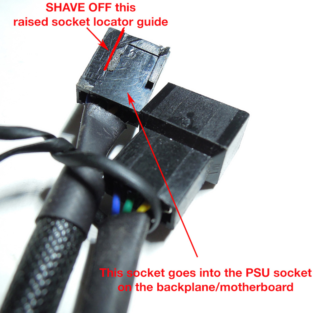

4.1 IMPORTANT :
The Noctua fan cable socket ( where it connects to the backplane) - has TWO raised locator guides !
ONE of these needs to be SHAVED OFF )
Use a hobby knife with a new blade. This SHAVING will allow the cable to 100% allow it to connect to the
backplane PSU power socket.

These cables are included in the NA-FC1 PWM speed controller kit
4.1 IMPORTANT :
