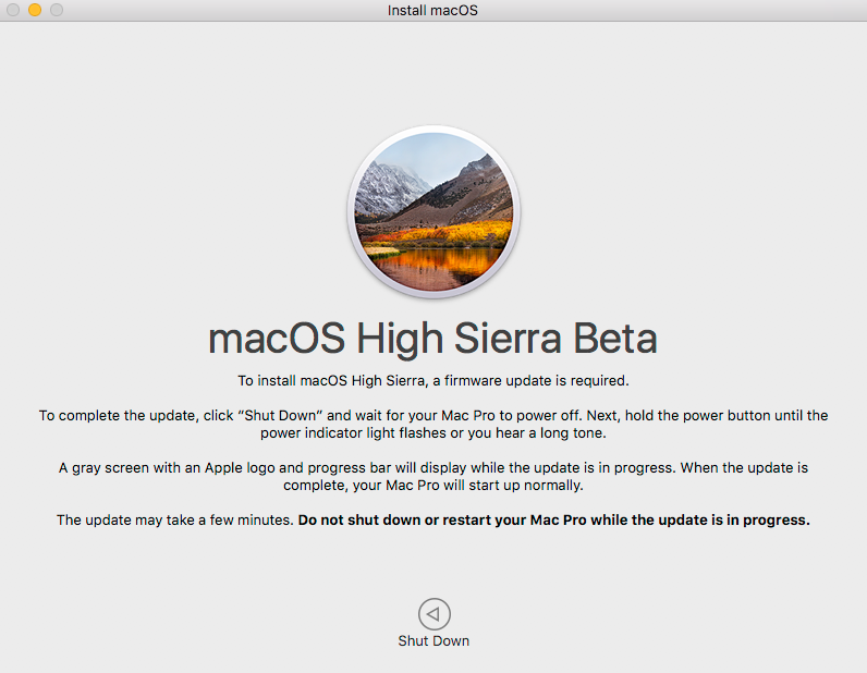

Does anyone have this configuration working with High Sierra? And if so, how did you install it successfully?
I'm running an Early 2009 Mac Pro with upgraded processors, memory and an RX 480 video card with Sierra and when I run the beta installer it never succeeds with the installation. I proceed as the installer instructs with a shutdown. I then hold the power button until the power light flashes rapidly and upon release a loud and long sound plays to indicate firmware update. After allowing this to proceed for some minutes, the system works for another few minutes and then 10.12.6 starts right back up and I get the same Install macOS screen again as when I first started:
You must have an Apple efi card installed to complete the firmware update—the update will not proceed with a RX480.
Yes, you're spot on @nekton1. Thanks. I had to put my old video card back in and once I did that installation proceeded.
