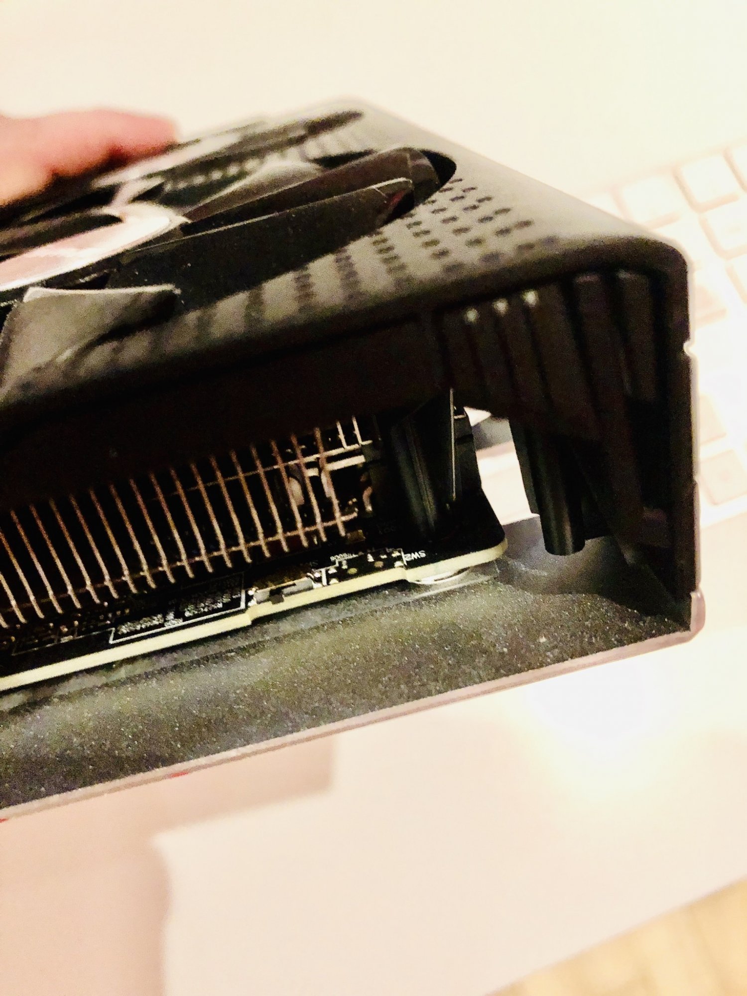

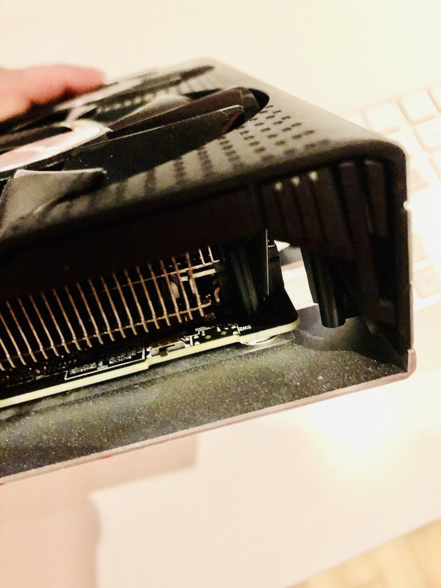

RX580 has two BIOS installed with a switch, one standard that works with OpenCore and one Performance that does not (right side switch). By default is set to Performance, as soon as I set it to Standard (left side switch), bootpicker worked properly and I was able to see the boot screen.
You can see the tiny switch located under radiator fins, into picture I just took, try it on Left side like it is now:
Yeah, I think they call it gaming mode and mining mode. Users reported that only gaming mode can show boot screen, but the switch default at the mining mode position.
Legend, this actually bloody worked, so happy, I totally forgot about that switch, I had the same issue, flicked the switch and it works like a dream now. Thanks again,
