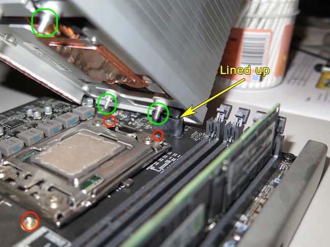

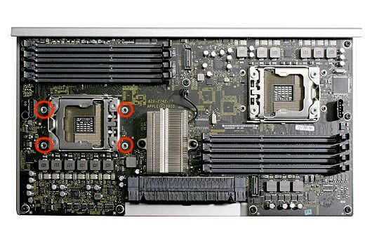

I don't have pictures from the right perspective , but I can show you what the two separate parts look like .
HS is short hand for heatsink , in the industry .
The CPU Heatsinks each have four retained fasteners . They insert into the Tray's standoff holes .
Here are the CPU Tray heatsink standoffs for CPU A of your Nehalem DP Mac Pro . This is for a factory 2010 - 2012 model . A 2009 model would look a little different . The CPU Tray heatsink standoffs are circled in red .
And here is a CPU heatsink from a Nehalem DP Mac Pro . The CPU Tray heatsink standoffs are circled in red . The CPU Heatsink fasteners are circled in green . They drop down when the heatsink is held level . They also lower further when tightened with a driver , once placed onto the CPU socket .
Unfortunately , I don't have a close up picture of the connection of these two components . But observe this connection area while you are tightening the fasteners .
