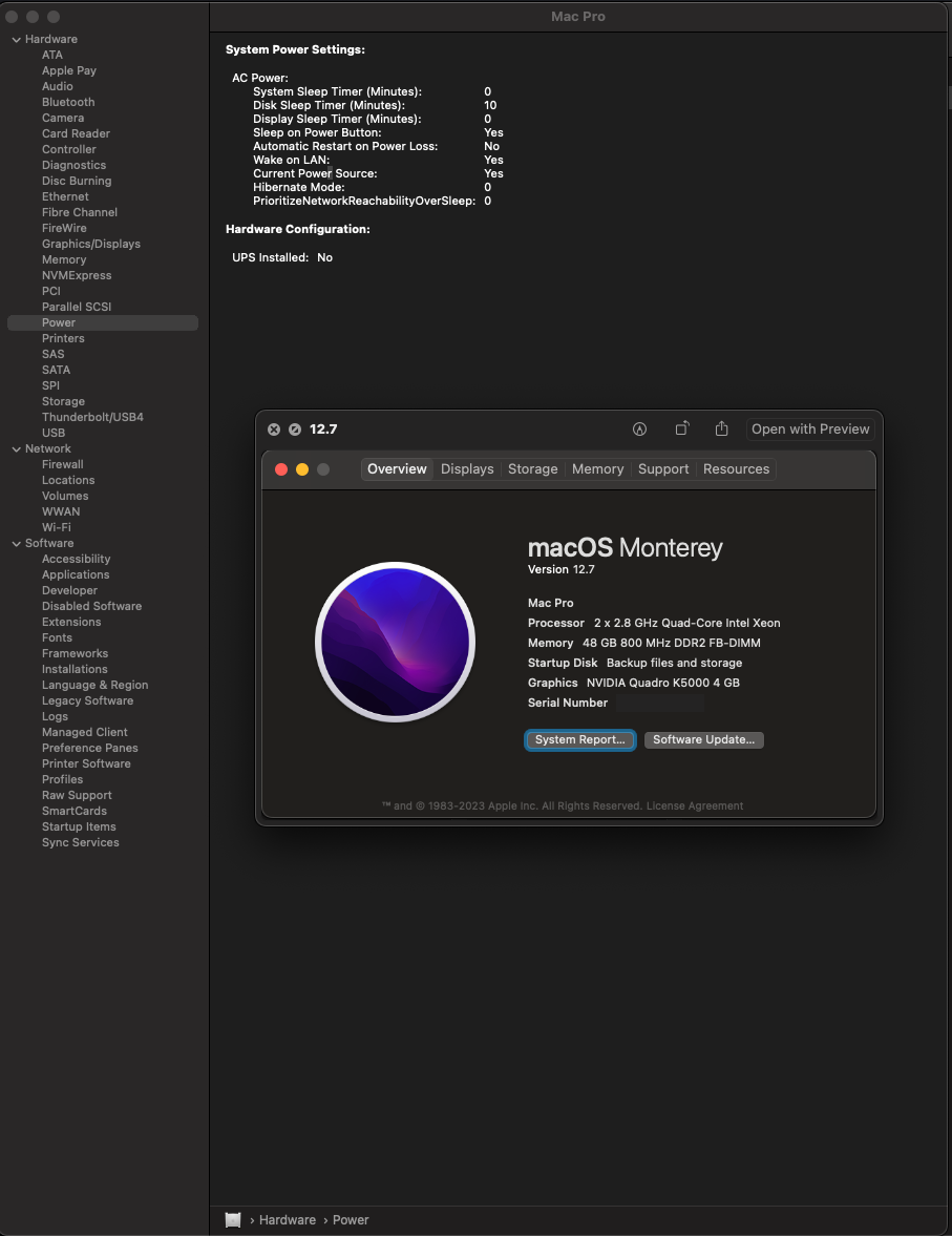

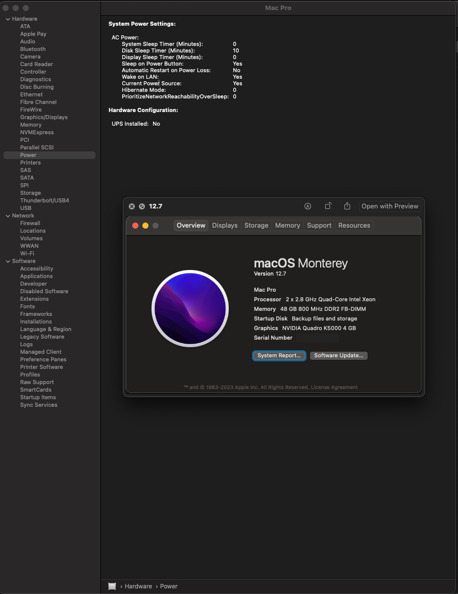

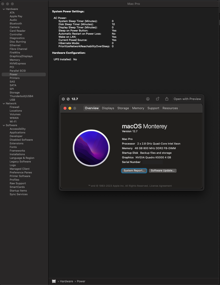

Just out of curiosity I put my 3,1 in "Sleep" mode and it "slept". White power light pulsates until I hit the space bar. To know why yours does not work, I am not "that guy". But since you mentioned appearing to be power related I took a screen shot of "power" under system report. If you think any of the titles in the left hand column will help with a highlight, mention that specific item and I will show the settings.
Thank you very much for posting the screenshot. Your settings look identical to mine actually so I suspect it's something else.
It's quite a mystery why this computer won't sleep.
