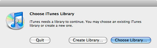

Two ways:
1- Move your iTunes Database File (.ita) to a different location, like a USB stick. When you open iTunes it might (I think) create a new one automatically.
or 2-
You would have to create a new iTunes database library. First go to Preferences, then the advanced tab and select 'keep itunes folder organised' and 'copy files to itunes folder', if done so already you can skip this step.
Then consolidate your library, do that by File > Library > Consolidate Library.
Close iTunes. MOVE your iTunes library to a different location, preferably an external drive. Open iTunes holding down on the option key. It will ask you to create or choose a library. Choose 'create'. Your iTunes library will be blank. Then drag and drop the entire iTunes Music Folder into the library to add all your songs.
Only setback is your song ratings may disappear, songs names may change and any playlists will disappear. There's other options in iTunes like export playlist that might help with this.

Thanks a lot for the help! Unfortunately, this did not work. Looks like there has to be something wrong with the iPod mechanically. As far as I know I have tried everything.
