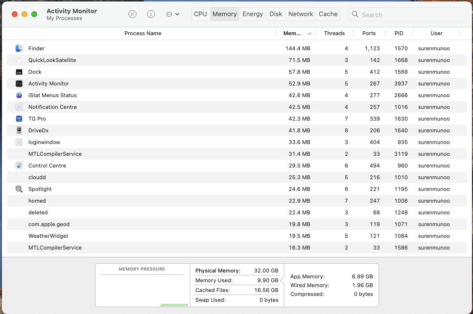

Hey All, Can someone tell me if the cached files under memory is something to worry about. It is sitting so high even after I cleared the cache. I also noticed while using Parallels desktop for Windows 11, the system started using swap memory. Its the Base model M2 Max Mac Studio with 32G Memory.
You are not using Swap at all at that time.
The memory pressure graph is almost not there.
Memory is there for the system to use it.
You can watch that Activity Monitor, particularly if you are using a Windows system running in a VM (similar to how Parallels works). If you see that memory pressure graph start to fill up that little window, then turn yellow, then red - you could be legitimately concerned, but, then you should also watch for actual affects from high memory usage, such as noticeable lag/general poor response from your system in actual use. Not much going on? Smooth operation? video performing normally.
That memory pressure graph is red, and filling the box? Everything slows down? There's when you should have a look at what is causing that.
Cached files are, for all intents and purposes, free memory. I don't want to get too technical here (I can explain more if anyone is curious), but essentially, Mac OS is going to try to fill unused RAM with anything that it can cache in order to try to make the best use of it, but it will just start purging the cache once the RAM is actually needed for something more important.
You don't want to purge the cache manually, it contains a lot of pages from the disk (cached files) that belong to applications you might have opened recently, or might open in the future, etc. Mac OS will manage all of that for you, it will clear it out any time it needs to and there is no action that is required from you. In fact, trying to clear it manually yourself might actually worsen performance rather than helping it.
Also, memory pressure generally is a much better figure to look at than the actual "memory used" number on Mac OS. This is because MacOS is a bit weird with the way it manages memory and can be confusing with the way it reports usage (it can make it appear that the system is more memory starved than it actually is). Memory pressure usually gives you a much clearer picture of what's actually going on.
- Green memory pressure means you have plenty of memory available and are nowhere near your limit (no matter what Activity monitor says with regards to "in use memory").
- Yellow means you're getting closer to your limit. You still have memory available, but MacOS has made this possible by compressing and swapping data more aggressively. Most workloads generally still run fine in the yellow.
- Red means you do not have enough memory for the workload you are running, and your system will have major performance slowdowns.
Apple's support pages have some good documentation on some of this as well:
- Memory Pressure
- Activity Monitor RAM reporting
Clearing the Safari cache (which is what I'm guessing you did, the one that caches assets downloaded by the browser on disk) has nothing to do with the operating system's file or buffer cache (which caches recently accessed files in memory) except for cached assets being files, too, but that's not what this is about.
Having 16GB of cached files and no memory pressure is a good thing, you have enough RAM and the OS is keeping a lot of recently accessed data in memory, your computer should feel very fast and snappy and continue to do so for the next couple of years unless you start using some heavy hitting professional applications.
@ArkSingularity Can one even manually clear the operating system's buffer cache? I know of sync(8), but that only flushes pending writes, nothing more.
Walls of text above.
The only thing in that graph worth looking at is the memory pressure. Yours is very low and green.
Forget everything above it. Only start even thinking about getting concerned is if it goes high and red.

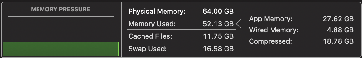

Exhibit A:
Am I concerned? Not even slightly.
Yours looks better. Mine is showing 52 GB memory used. Memory pressure is all green though.
