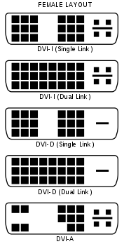

Thanks very much - the diagram helped me to identify what kinds of DVI I'm working with.

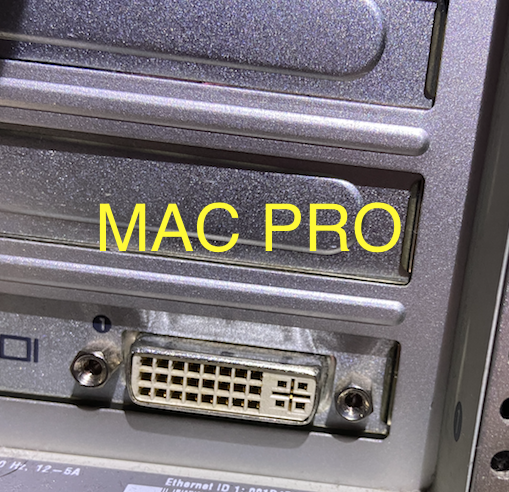

The Mac Pro has dual-link DVI-I ports.
The DVI to VGA adapter is also DVI-I.

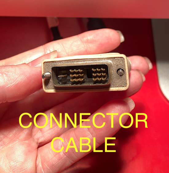

Oddly though, the connector cable I've used for years to connect my monitors to the MP is DVI-D. Maybe that's the problem. I've used these cables for years connecting the MP to 2 monitors with no problems. But I'm guessing this may be why the adapter isn't working. Maybe it would work if I replaced the cables with DVI-I cables, although I'm not sure yet if it's worth the cost instead of just buying a new monitor. What do you think?

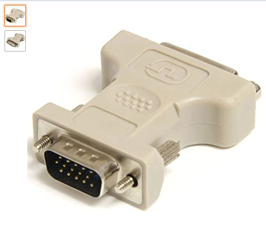

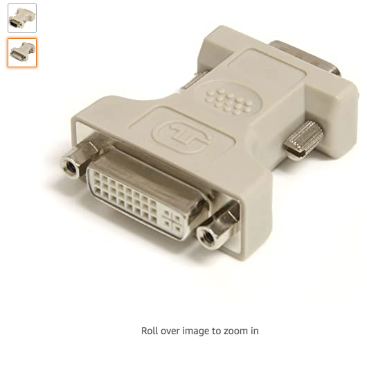

Adaptor: https://smile.amazon.com/gp/product/B000IE9U3Q/ref=ppx_yo_dt_b_asin_title_o04_s00?ie=UTF8&th=1

Um, I don't think that my cable is 'active', but it's not that small either, and works perfectly. I've never had a problem with it not working. I can take a shot of it later. I guess I'd be surprised if it was a 'active' adapter cable.

Startech says about that adapter:
Please Note: This product is intended for connections between DVI-I devices, passing an analog signal, to VGA devices. If your device uses a DVI-D connector, please refer StarTech.com's DVI to VGA Converter DVI2VGACON
So that would be the wrong adapter for your use.
I think the right adapter for your use from Startech would be:
The DVI2VGAE active DVI-D to VGA adapter lets you connect a digital DVI output from your desktop or laptop computer onto a VGA monitor or projector, saving the cost of upgrading to a DVI-D compatible display.

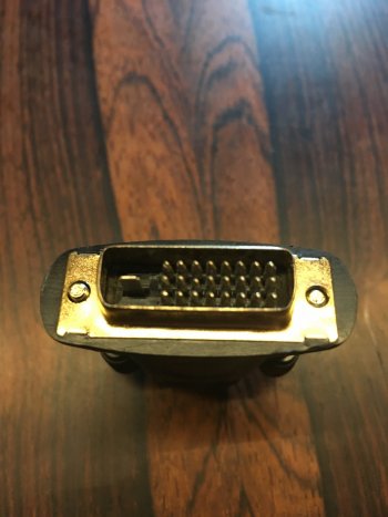

After searching a bit, I found the adapter I used for the Mac Pro 2008 (GPU HD 2600 XT) in a drawer.
This one also works with a GT 120.
It's a DVI-D dual link to HDMI adapter and looks like this:
Reactions: DustyShaw
