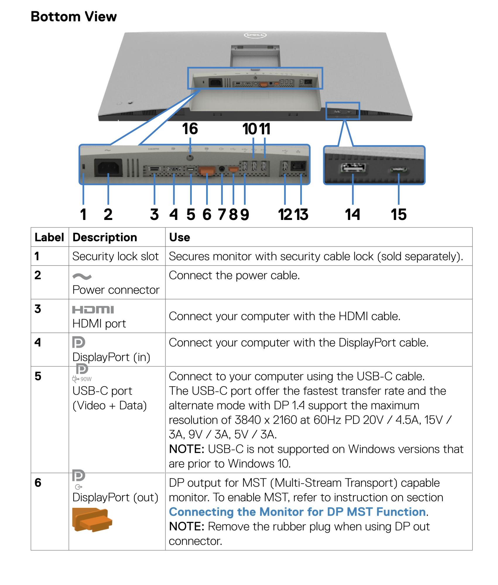

Hi,
I want to be able to share the same keyboard & mouse with 2 computers connected to a Dell U3223QE monitor but I haven't been successful:
  1. MacBook Pro 16 2019 running ventura. It connects to the monitor to port 5 - USB-C port see the bottom view here : https://dl.dell.com/content/manual12003775-dell-u3223qe-monitor-user-s-guide.pdf?language=en-us . I used the USB-C 1.0 M cable.
  2. PC running Pop!Os 22.04LTS (based on Ubuntu). I connects to the monitor to port 4 - Display Port. I used the DisplayPort 1.8 M cable (DisplayPort to DisplayPort)
  3. Mac keyboard and mouse that are both wired and they are plugged into the usb ports 9 & 10.
I also have an additional wired keyboard and additional wireless mouse for the PC. They are plugged into the PC.
I can switch between the 2 using the joystick behind the monitor but the mac keyboard doesn't work for the PC, it sends the input to the mac and the same is true with the mouse.
How did you set it up? Could you please tell me what connections did you use and where in terms of the numbers in the picture?

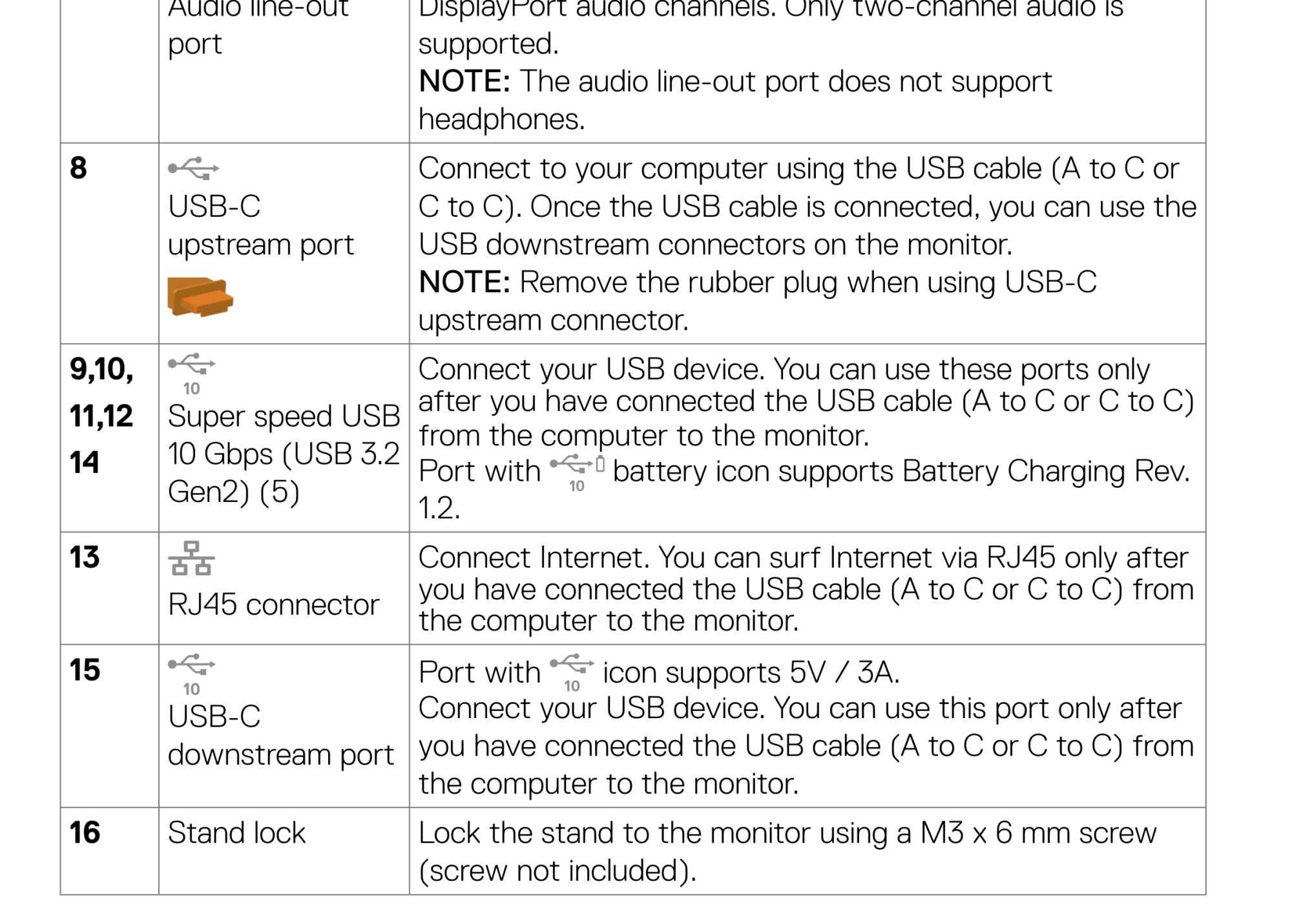

You have to connect your PC to port 8 in addition in order to be able to use your KVM. This is how it works for me. MBP - port 5, Mac mini - port 4 + port 8.
Reactions: bikerc
Yes, exactly, I just got it working like that. Go figure. Thank you!
