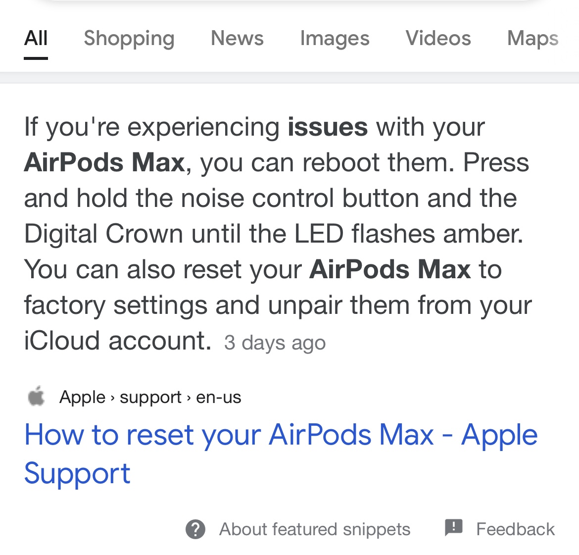

My partner was able to reset my pair by using this method:
He said he held both buttons for about 20 seconds and it went from green to amber to flashing white.
Try this and see if it works for you.
Reactions: paris1129
I had this problem when I first got them. I followed the reset instructions above and paired them again and haven't had an issue since.
