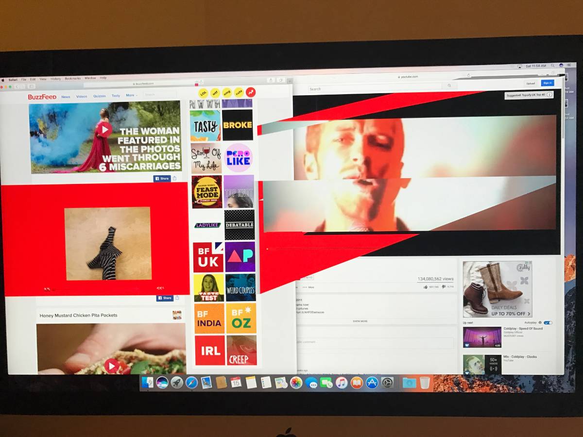

I have an iMac that is essentially unusable due to constant freezing and restarts. The frequency can be multiple times per hour and it seems to happen more often when video or images are being displayed in a browser window. I am currently running macOS Sierra, but experienced the issue under El Capitan and Yosemite when they were installed. It feels as though the issue has increased in frequency over the past year, but I did not keep count. The frequency started to occur enough that I gave up trying to live with it and decided to contact support. I was hopeful that Sierra would fix the issue, but that was not the case.
As you'll see below, I have contacted support and dropped the computer off at the Apple Store, but Apple states there is no problem. After doing my own troubleshooting based on research in various forums, I am posting this as my last gasp hope that someone has a silver bullet that fixes this crippling issue. If I can not find a fix, then my only recourse is to contact Apple to return the computer for a full refund, or get them agree to replace the computer with a new, working model. Curious if anyone has had success with this approach for this model of iMac after experiencing similar issues.
Thank you in advanced for your assistance. I am open to all suggestions at this point. If you need more information please let me know and I’ll do my best to provide it as quickly as possible.

Behavior and Symptoms Experienced:
- Computer will freeze and all windows and menus become unresponsive. Most of the time I can still move the cursor around on the screen, but that is the only aspect of the system that seems to work. If there is music/audio playing it will continue to play uninterrupted. After 1-3 minutes the windows/menus become responsive again and I can continue to use the computer.
- Computer will freeze as described above, but never becomes responsive again and eventually restarts to the login screen. The user account has been logged out in this case. After I login again, the computer seems to work normally again until the freezing occurs again.
- Computer will freeze as described above, but never becomes responsive again and eventually goes to a black screen and the computer restarts displaying the Apple logo and progress bar.
- Periodically when the computer freezes and prior to restarting the fan can be heard spinning up and becomes very loud. In this case, it usually goes to the black screen described above before rebooting.
- In some cases when the computer freezes portions of the screen turn bright red and the windows appear to break apart and are displayed in a fragmented fashion. Today, I was able to capture an example of this with my iPhone in the attached picture. There are two Safari browser windows in the picture attached and the bright red displayed was not part of the original web pages.

Below is all the troubleshooting steps I completed after bringing the iMac home from the Apple Store. The steps below are cumulative in that each change I made remained in place for the subsequent steps, so with each step more variables have been removed from the environment to hopefully narrow the possible causes of the issue. In all of the cases below, the only software installed on the iMac is what comes standard with the OS, except where noted.
Based on my experiments last night I developed a test that has been successful in causing the freezing issue to occur, documented below. This is the test I ran after each troubleshooting change documented below.
The Test
- Open Safari browser window
- Note Safari is the only application running during this test
- Go to youtube.com
- Play a music video, I used "Coldplay - The Scientist" in each test, so it was consistent from test to test. Also, it was first video I ran across that I could stand listening to over and over.
- While the music video is playing, open a separate browser window in Safari
- Go to buzzfeed.com
- Click on "Videos"
- Begin slowly scrolling down the page, pause until the first video begins playing
- Let the video play for a few seconds and then scroll down to the next video until it starts playing
- Repeat this process for each video letting each one play a few seconds until the iMac freezes
- In most cases the iMac freezes before the Coldplay - The Scientist video finishes which is 4:26 long. Occasionally it will start the next Coldplay song, but this is rare, and I almost always experienced the freezing before the second song completed.

- As mentioned earlier in the post, the screen image does display strange artifacts during some of the freeze ups. Screenshot attached and another one in the dropbox folder linked below.
- After one of the freezes and restarts I captured logs from the console app. There were 16 entries titled with the following naming schema, “Kernel_YYYY_MM_DD_TTTTTTTT_TESTs-iMac.gpuRestart”. These logs are also in the linked Dropbox folder. These occurred during the same restart that I captured the screenshots from.
- As I browsed the logs, there multiple mentions of a “GPU Restart” immediately prior to the crash and restart. I tried to capture as many of the logs that looked to be relevant to this issue and included them in the Dropbox folder.
- After one restart I received a pop up from the system wanting to send information to Apple regarding a, “Sleep Wake Failure”. I captured the details and included in the Dropbox folder.
- Below is a run from EtreCheck since that seemed to be a common request in other posts.
