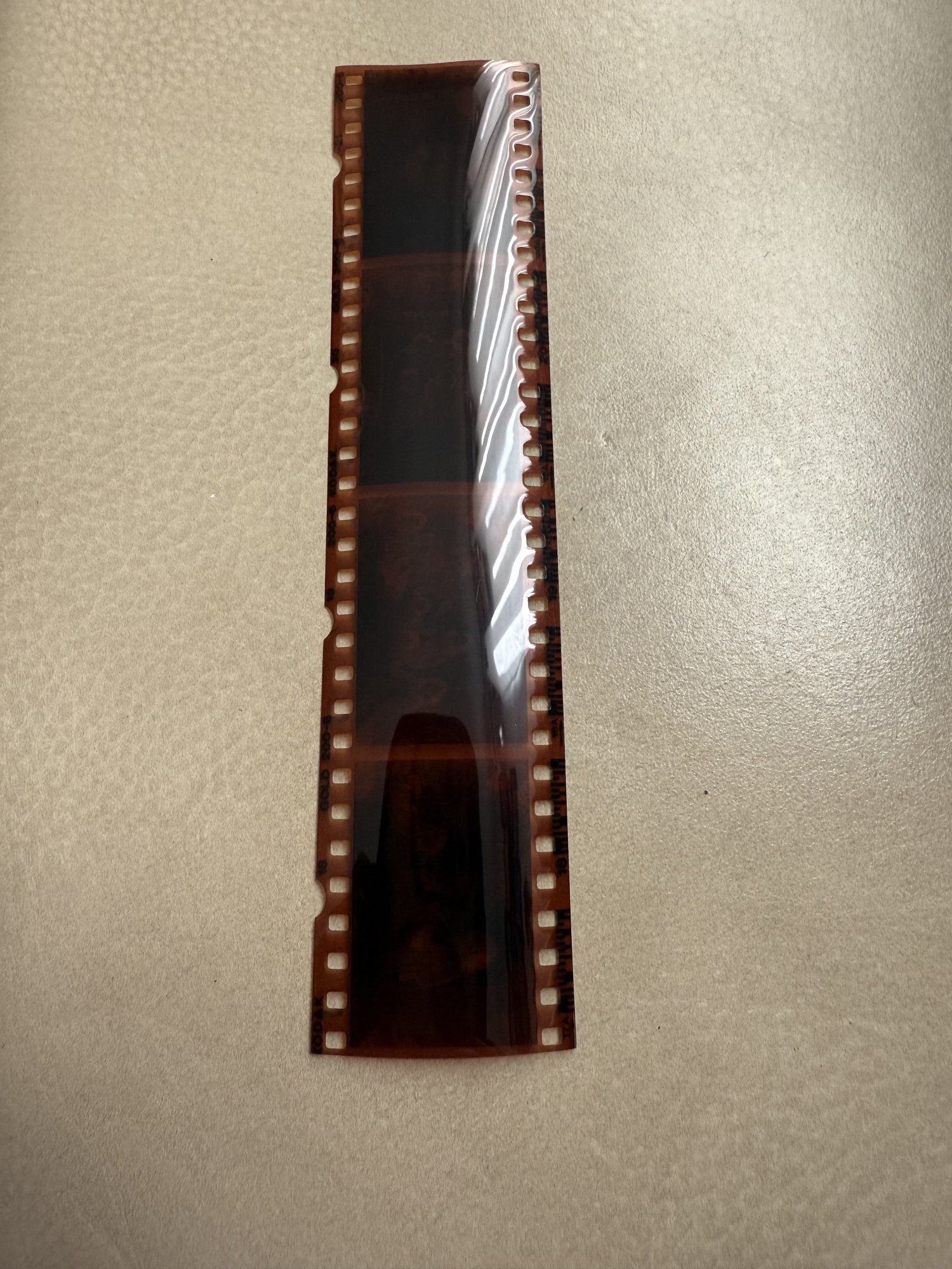

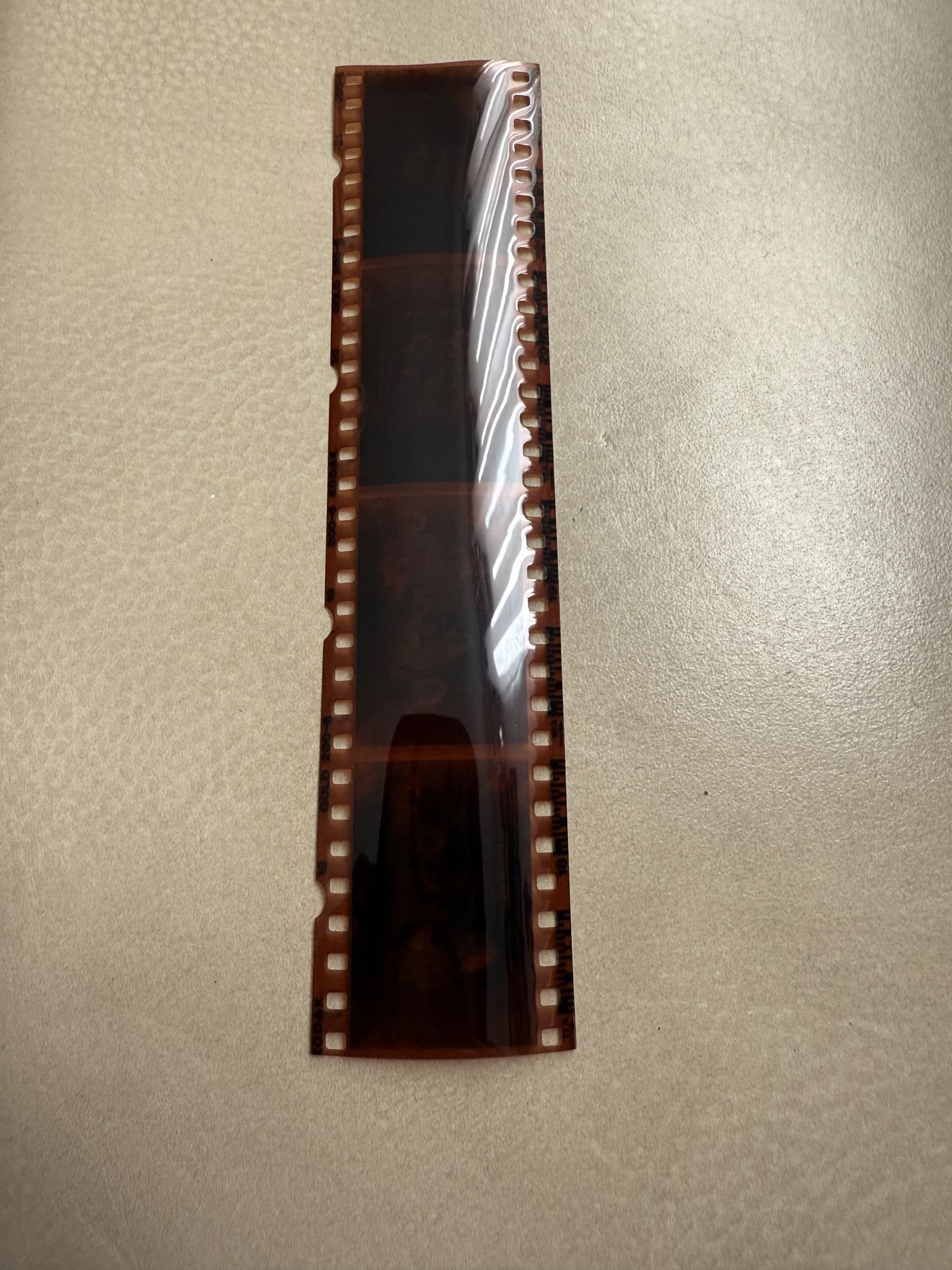

Does anyone know how to convert these photos to modern day technology aka digital
Your best bet is probably a photo service at Walgreens, Costco, etc. You’ll probably have to mail the negatives in, but they will be able to digitize the images and provide them on DVD, USB, or via download.

You need a good film scanner or a good digital camera with a proper macro setup similar to the old "slide duplicators" to photograph each frame.

Is it just these five images, or are you just showing those as a representative sample? Are you wanting to print them or just use them for social media?
There are several apps for iPhone that you could do that won't be the best 100% quality, but would be good enough for social media. Basically you take a photo of a single negative with your phone on a light box of some sort (an iPad could work) and then the software will convert it for you. FilmLab, FilmBox, and SmartConvert would be ones that I'd consider.
If you have hundreds of negatives, then you'd want a different solution, but if it's literally just these five, then I'd try one of the apps.

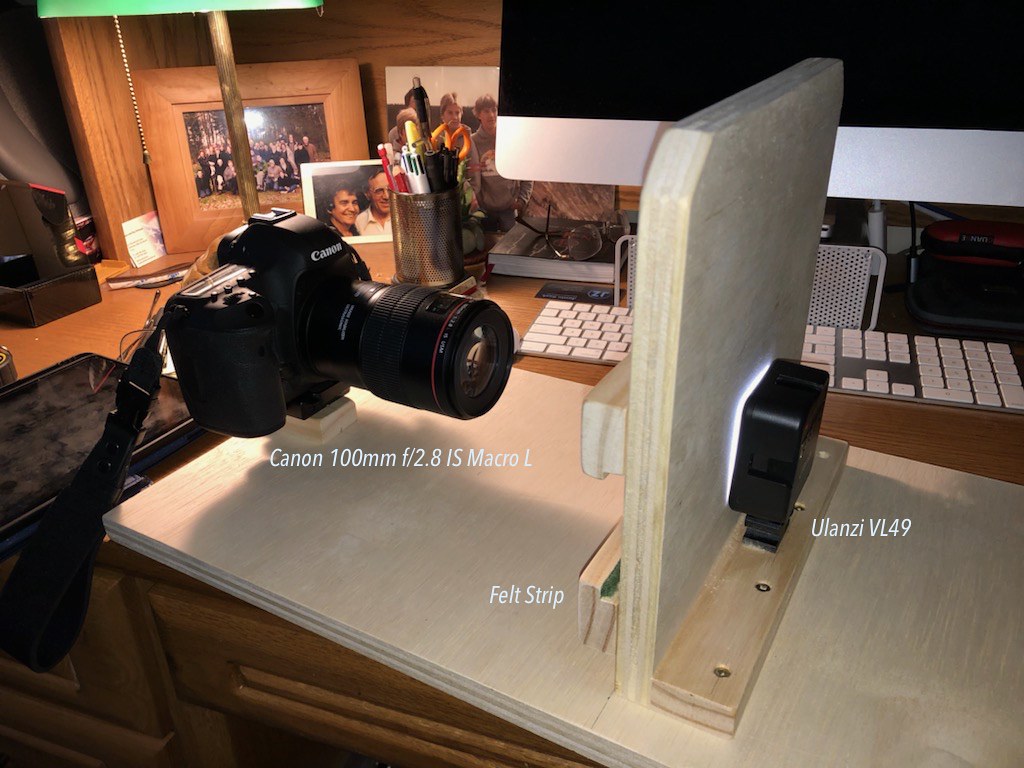

As noted earlier, a scanner designed for slide/film scanning, or something like I built - a light box to backlight the slide/film and macro lens. Back in the day, there was an attachment replacing lens that was an extension tube and firing a flash into light dispersing cover. I don’t believe they make them anymore. The problem with taking a photo is that it is a photo of a negative. A scanner automatically converts it to a positive, but a camera based copy will require a software application in post. While I have a film copy capable scanner, prefer the macro light box method RAW photo as amazed at detail and dynamic range “copied” that wasn’t apparent in the original. It is amazing. That said, my son has a relatively inexpensive film/photo scanner that is quick and does a good job.

I bought the Z50 mainly for this exact purpose and have been delighted with the results. Working from Gold 100 films if the focus is crisp and exposure good, clean 16x24 prints can be expected, 12x18 is a given. I went APSc because the macro lens focuses to 1:1 on a full frame. On APSc I can crop a bit in camera and there is still enough headroom for the auto focus to perform flawlessly. With full frame probably best not to work right at 1:1, rather leave a bit on the edges so the auto focus can do its thing, then do a bit of cropping post image.

In my case this set-up was my first venture into the mirrorless interchangeable lens world. Dollarwise the set-up was in the same ball park as a good film capable scanner, but a good deal faster. I was perhaps a bit unique in that a new scanner would not have been compatible with my old MacPro 4,1, so adding a new computer would have bumped the scanner price a lot. Also fortunate in already having a a good tripod/head combination.

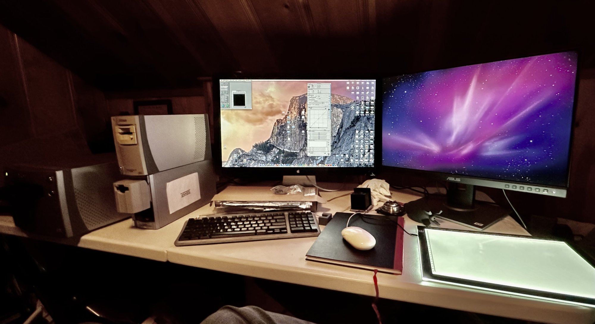

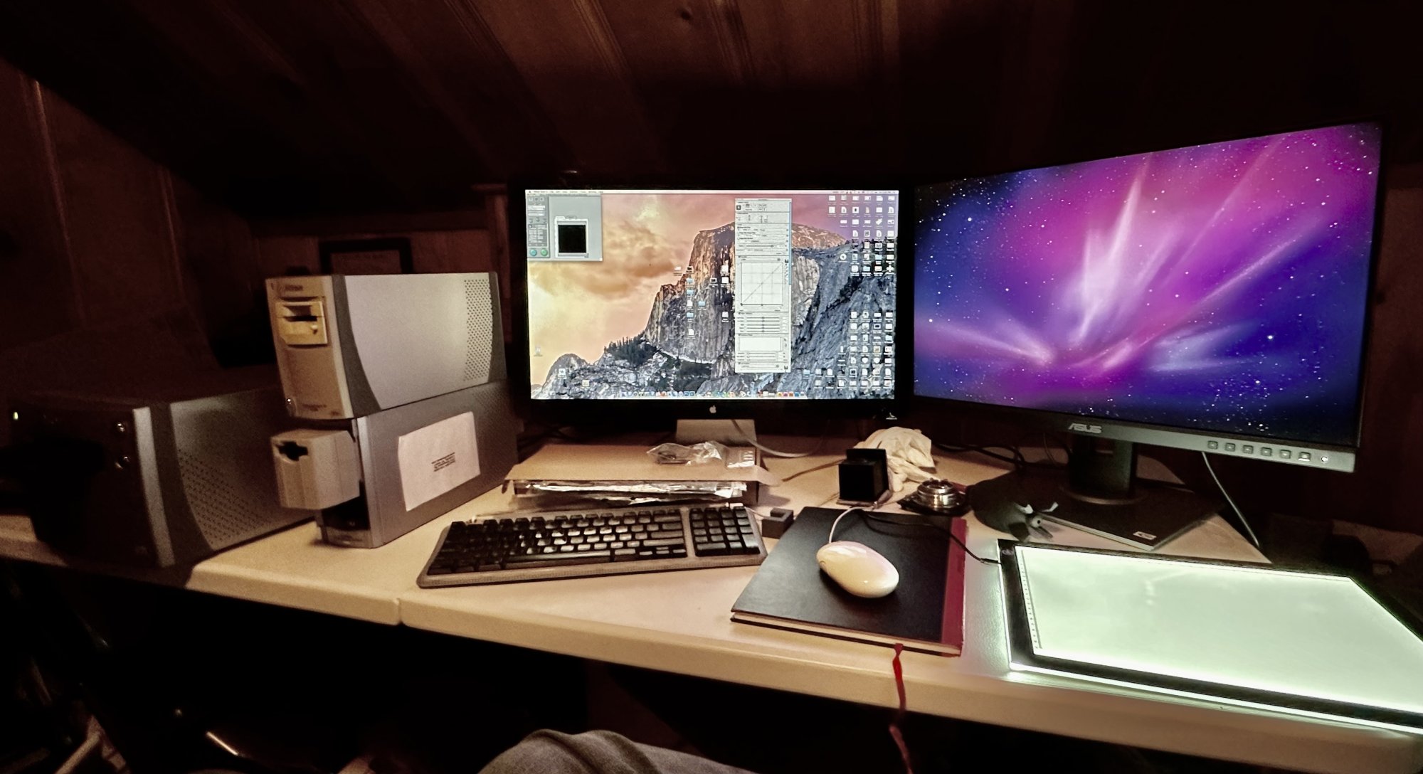

Depending on how nutty you want to go, this set-up can handle almost any roll film I want to throw at it and is about as good as it gets within the realm of consumer scanners. I can pull more detail out of film here than any macro/camera set-up I've seen, and there are other benefits but it's slow(albeit there's some automation here too). With the flatbed added in, not shown, I literally can handle anything as large as 8x10 sheet film.
With that said, this was not all bought in one go, and has been upgraded over the years. It's also valuable to me as someone who continues to shoot film, so I often really only do have a few at a time to handle. You'd spend a lot of time here doing a big back-log of film.
