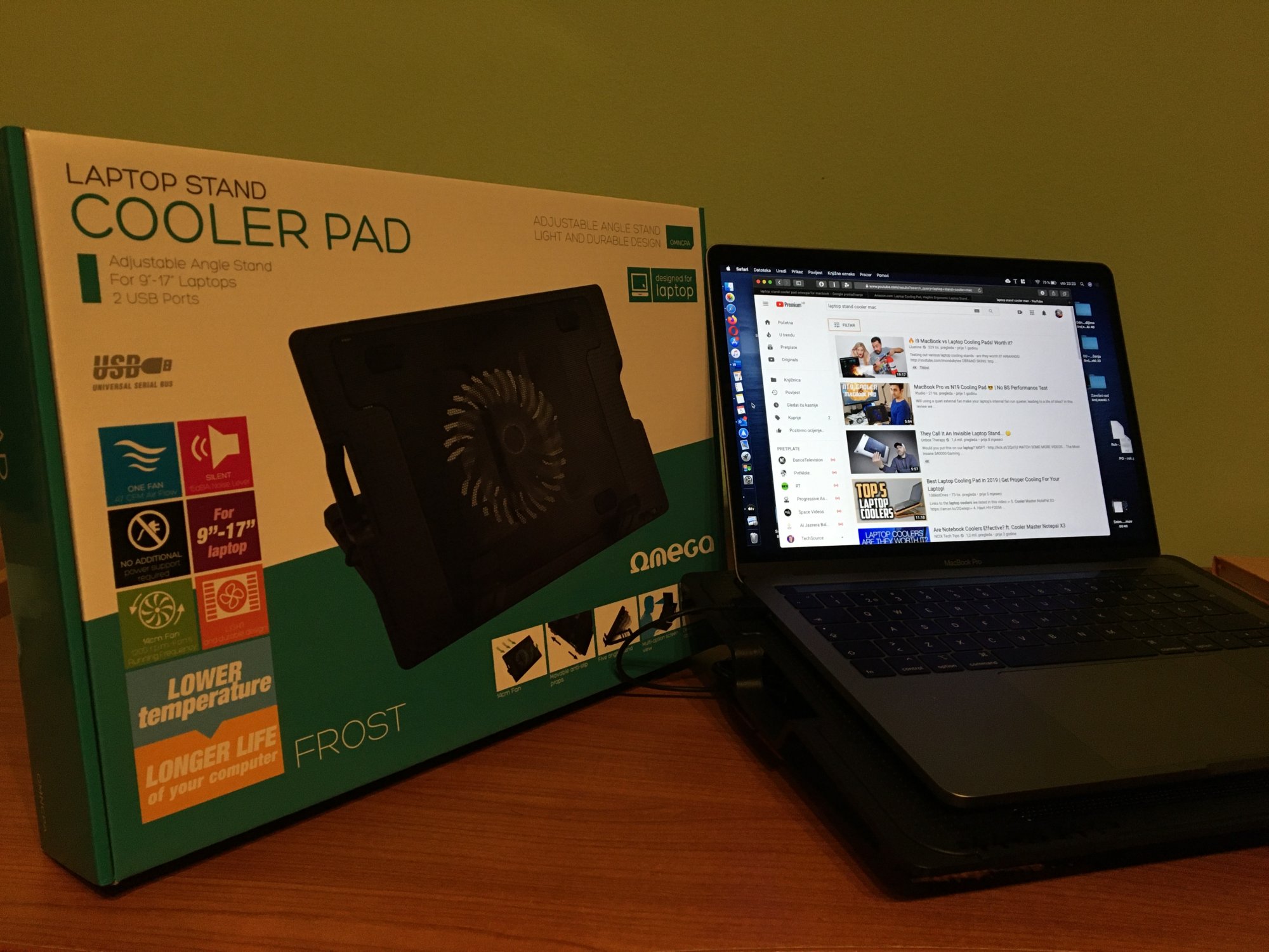

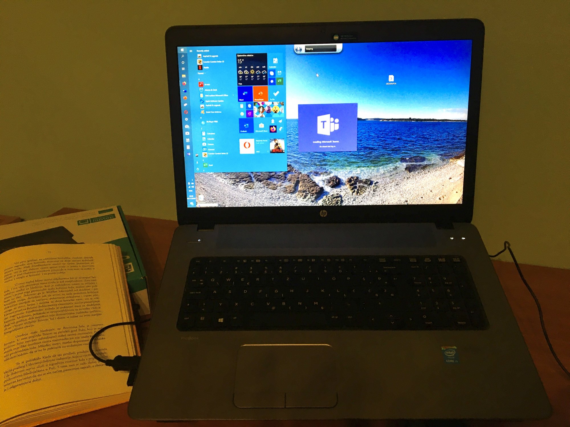

Hello I purchased a laptop cooler pad but when I connect it with my Macbook it does not work. Do I have to install drivers or something to work? It works with my win 10 laptop without just a usb connection but I don't find an answer online why it does not cool on the Mac.

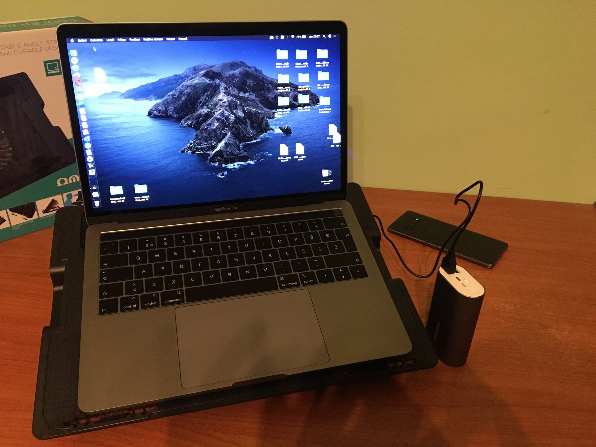

I use my powerbank so I do cool my Mac but I would like to try it without.
I took images of the brand name and second image shows how I manage to work.

On this laptop it just worked second after I plugged usb and I didn't have to wait or install anything so it is not a problem in the device.
Those only draw current from the USB ports power delivery. So, if the minimum Voltage and Current aren't being met, then there will be no operation. What are the power requirements? It's printed on the box and most likely on the cooling pad. Another likely reason, is you're using an adapter to connect the USB-A cable to the USB-C ports on the MBP. The adapter isn't passing the correct Voltage and Current.

That only occurs if there's a negotiated data connection with the OS from the peripheral. So, it's possible the USB ports have power disconnected from the USB-C port until activated by a hardware device. Since, this is just a cooler, then it would require this software recognition and not just from there being a cable plugged into it. I would think that the adapter should provide this ability to software activate the port with the OS. However, the adapter is probably limited or the OS limits total power supplied through the port since it's an adapter.

Thank for all the replys. @CHA05 R31GN5 good to know that, I will check the box. Another product said Windows 10 compatibile so I avoided that. I tought catch is in the operating system.
