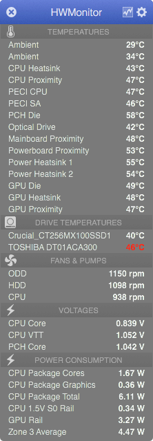

Fan control apps will also show you the temp of the sensors that control the fans. You can also use an app like HWMonitor, that can display ALL the various sensors in your 2010 iMac, and you can see exactly what is generating heat. You will also be able to see that the fan speeds actually increase. A fan control app lets you increase speed on one fan, or some combination of fans, if that works out better for you.

Here are the typical temperatures of this iMac at idle:
