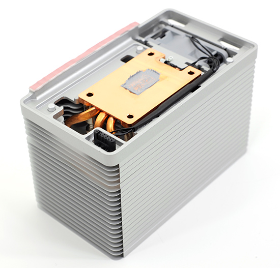

check the black plastic connector shown in the bottom corner of this picture ...it can break and not properly connect .
I had this issue on one . Everything works fine but fans high after post
