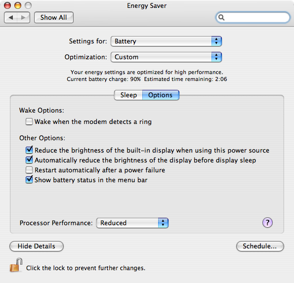

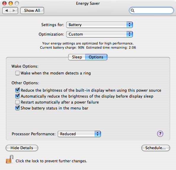

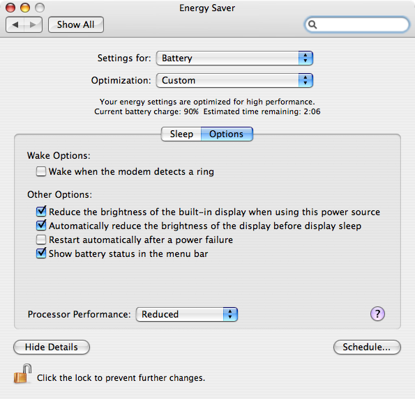

System Preferences/Energy Saver - there's an option to have the CPU running at fullspeed, a reduced speed or variable speed on demand:
Haha I expected it was just a joke, just didn't know if it was something important. Thanks for the battery settings, I haven't been able to test it but I set the Energy Saver settings to everything you showed in that picture.
I just tested the new settings, The computer was a tiny bit slower but I ran it in a virtual windows 10 machine in the InterWebPPC browser and it didn't overheat that much. It felt pretty normal when I touched the bottom of the computer. I think it did something.

I think the Reduced setting sets the CPU at two thirds normal speed so there will be a performance hit but hopefull less thermal issues.

I won't keep posting updates on this thread every time I use this PowerBook but I just did some Audacity recordings and YouTube and it didn't overheat at all. Setting it to Reduced may run it at two thirds of the full 867MHz, but when it overheats, it also slows down (thermal throttling?)
