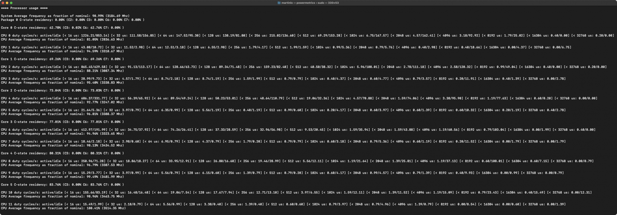

Just find out a way to monitor each CPU core's speed.
Open terminal and enter
Code:
sudo powermetrics --show-cpu-qos
When I run a yes command in the background, clearly the CPU run at the Turbo Boost speed.

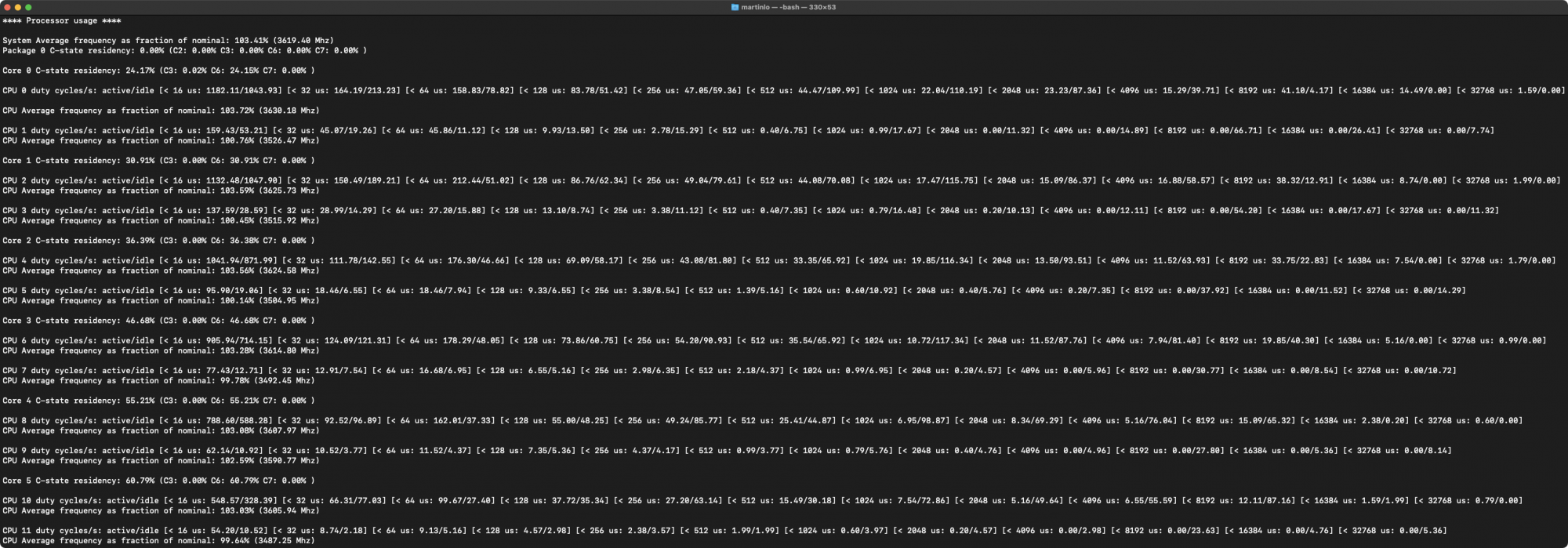

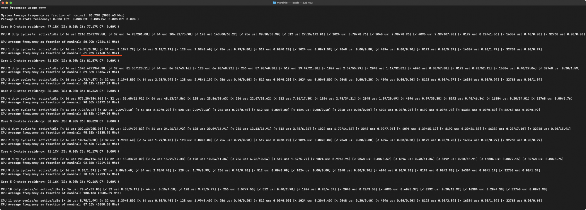

And some CPU core can run at quite low clock speed when at idle
So, it should be accurate
