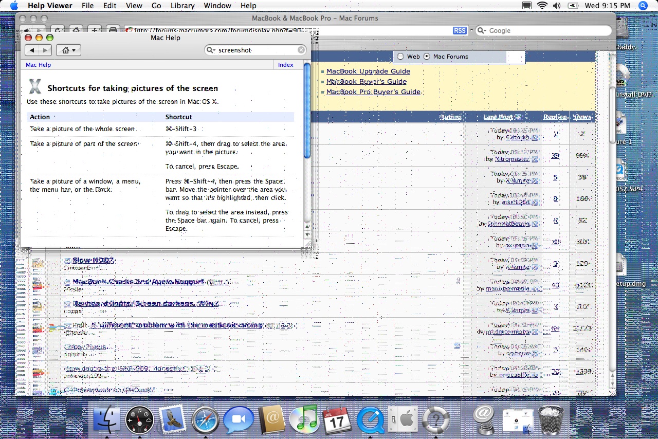

I will try the screenshot deal in an hour or two when I can get back in front of it. It did not happen when I had my Tiger Install DVD in but then again it doesn't happen all of the time anywhere.
The artifacts do show up in the screenshot.
Sorry about the file size but I didn't install any graphics apps yet.
Whelp, since that screenshot looks nearly identical to my problem and it may not show up on the installer, I'd put my money on a bum graphics chip. Not much you can do to fix that, unfortunately.
