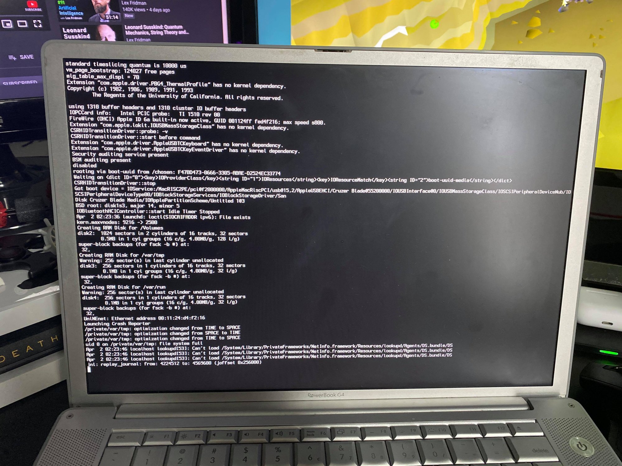

The furthest I got was installing the OS, it boots to single user mode, it doesent error at all in verbose and in normal boot it gets stucks at the "Starting Max OSX" screen.
Picture attached.

Ok, so now I remember. The CDs on macintosh garden are the only ones that got me installed(but nothing further), whereas the DVD that you pointed to always gets stuck here as soon as I boot into it. So this is before any installer gui. Verbose boot obviously. Thanks again for helping me!

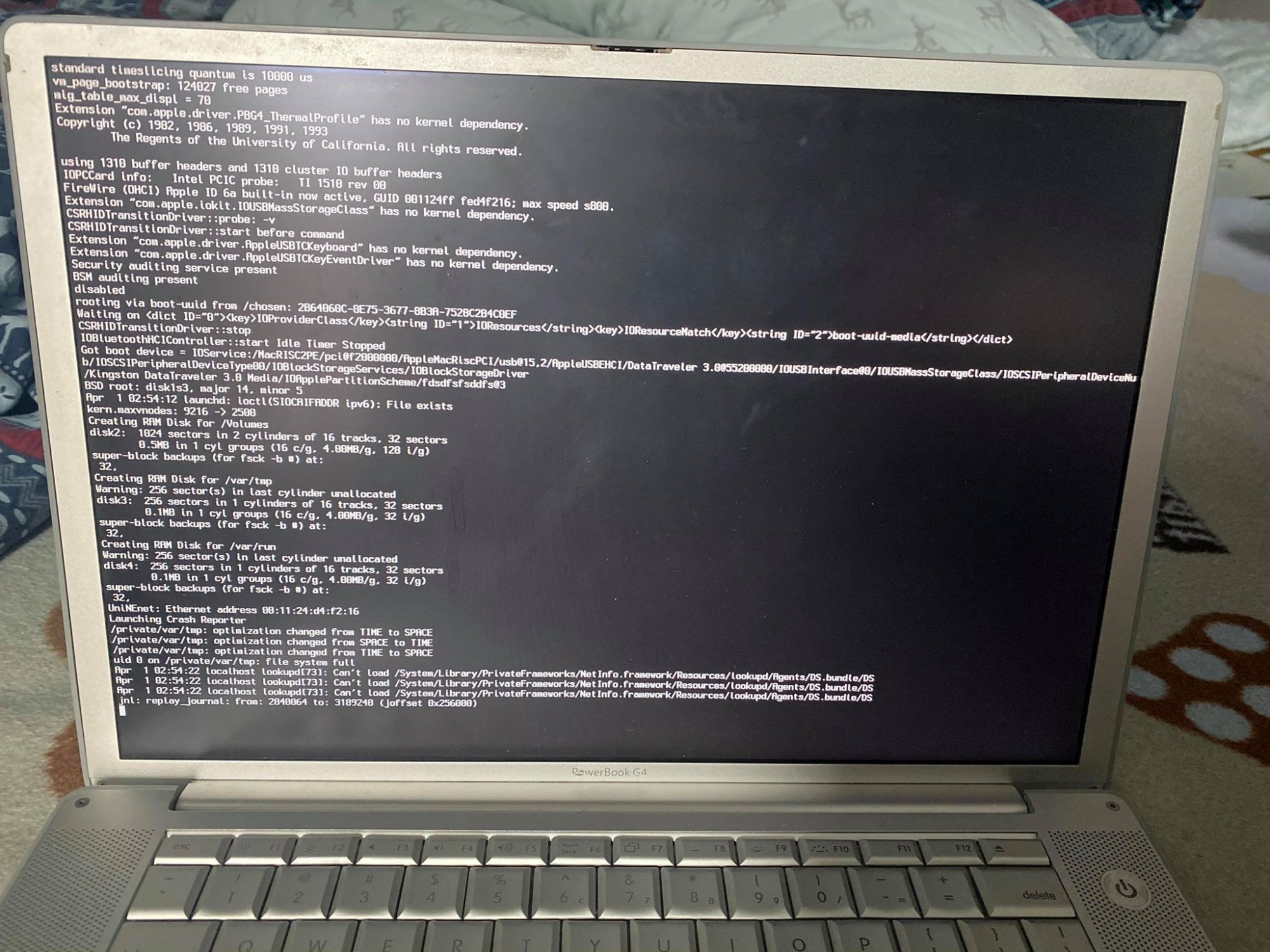

Seeing that boot error, I'd recommend trying a different flashdrive. I also have a drive that identifies as a "Kingston DataTraveler 3.0", and my A1138 doesn't like it. I get the impression that the USB ports don't give it quite as much power as it wants. I've booted from other USB sticks fine, but never booted from that one on my PB.

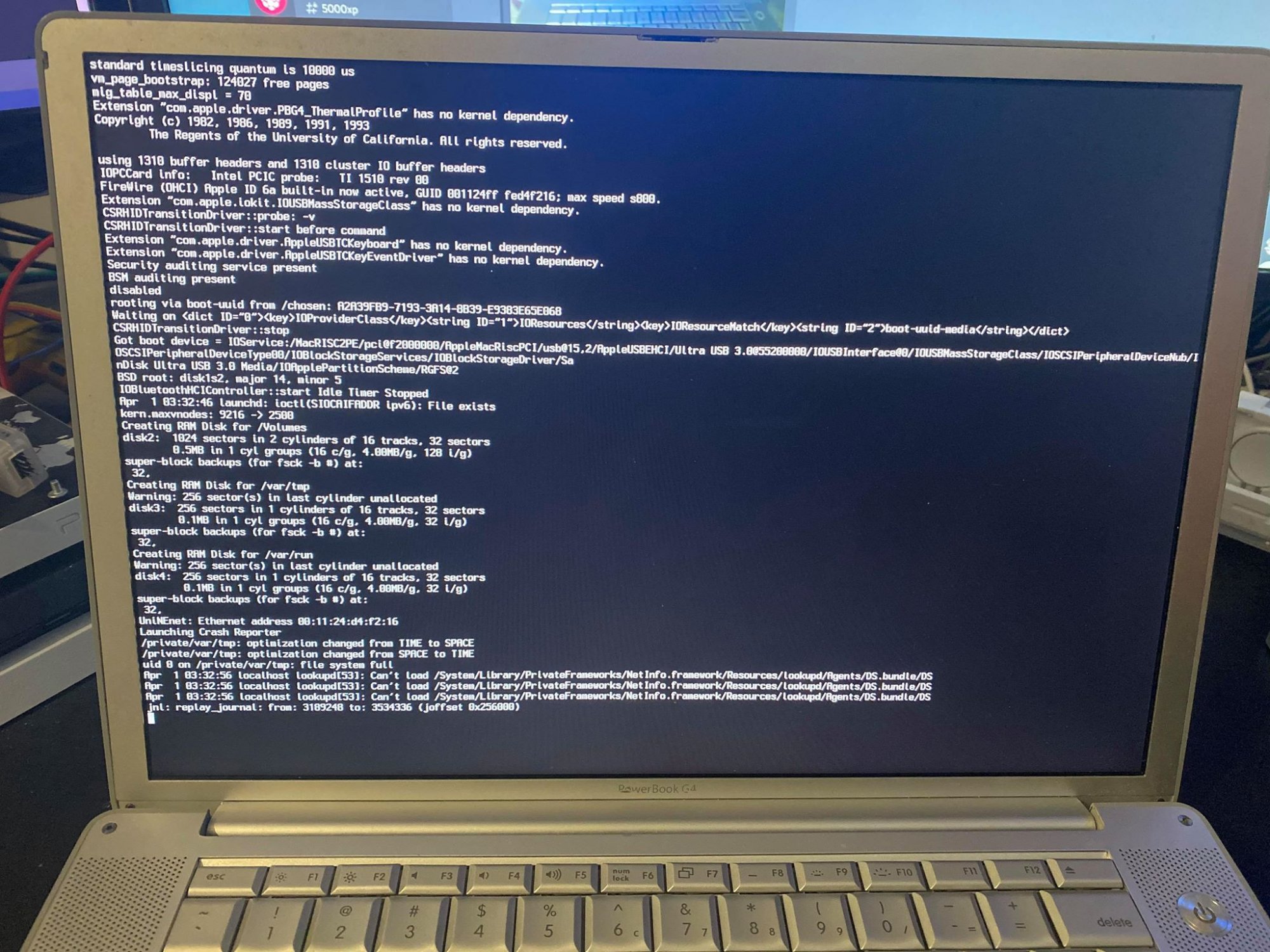

Ok. So this is it booting(verbose again. otherwise it loads forever in a loop like the other one) the same thing with a much nicer USB. Identical problem. I really doubt it's the USB. I am open however to suggestions!
Is this also a USB 3.0 drive (guessing based on the "Ultra USB 3.0" portion of the log)? If so, then better may not be better in this case. I tend to agree that it seems to be unlikely at this point, but an older USB 2.0 drive would be the best to fully eliminate that possible point of failure.

So my new USB 2.0 stick arrived. It is a quite reputable Sandisk 16 GB stick and I made sure this one to be USB 2.0 and also I bought it new to be as certain as I can that the usb sticks are not the problem here. I can only get as far as with my usb 3 stick and that is the "/private/var/tmp: file system full" error.
You have used the same image as I did and you put it onto the usb the same way. My usb is now not the problem, so the problem is the laptop itself.
Here is my reasoning now: tmp file systems in this case cannot reside on the bootable media because that is read only. So this one is loaded into ram. Saying it is full might mean there is a problem with my ram. Am I correct in following this logic?
I bought a new stick of ram and I am waiting on its arrival. Thank you!
So I got my new ram stick and lo and behold, the powerbook works. So for anybody in the future if youre reading this, it might be the ram. My powerbook worked perfectly on 10.5. Installed alright, but couldnt first boot 10.4 without new ram. Very peculiar. Thanks guys for the help!
