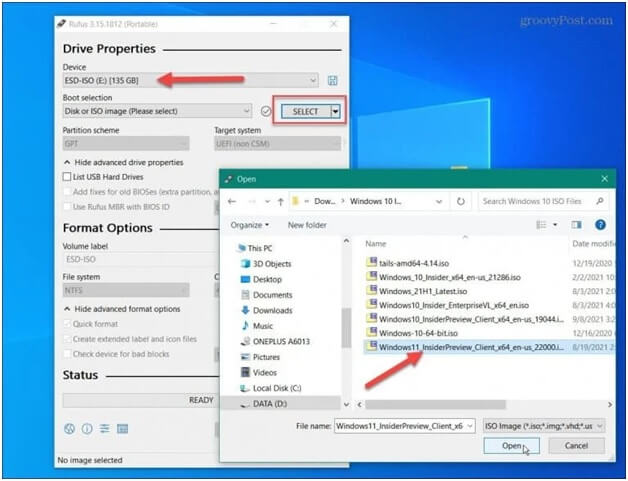

Hi, I just ended up installing through Rufus on another PC as Lo’s latest packages kept freezing if a USB was plugged in on boot. I followed the first link but used my SSD instead of a USB and then reset windows from settings after first boot to remove the Windows to Go drivers.
Afterwards I used the latest iMac Pro 1,1 bootcamp as per here and it worked wonderfully. Hope that helps!
