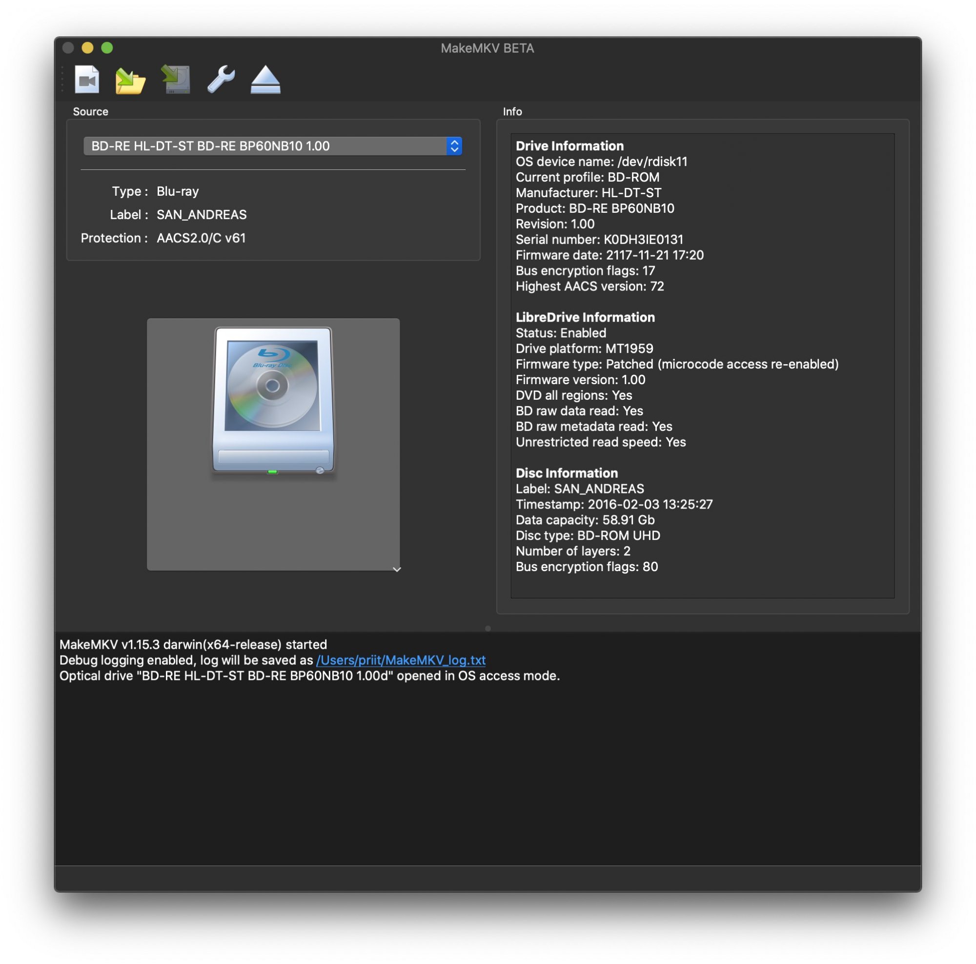

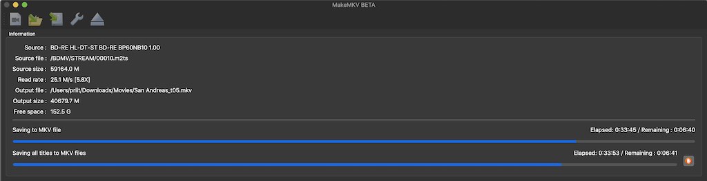

I use LG BP55EB40 (I like its slim form and USB-only power), reflashed with BP60NB10 firmware (as was posted on makeMKV forum) and it lost its riplock and started to read UHD movie discs as well.
That makes me think, that if I had bought BP60NB10 right away, I would be in the same place without the flashing.
Although flashing was a straightforward process.
View attachment 1987450View attachment 1987449
Were you able to flash it with your Mac, or did you have to use a Windows's box?
