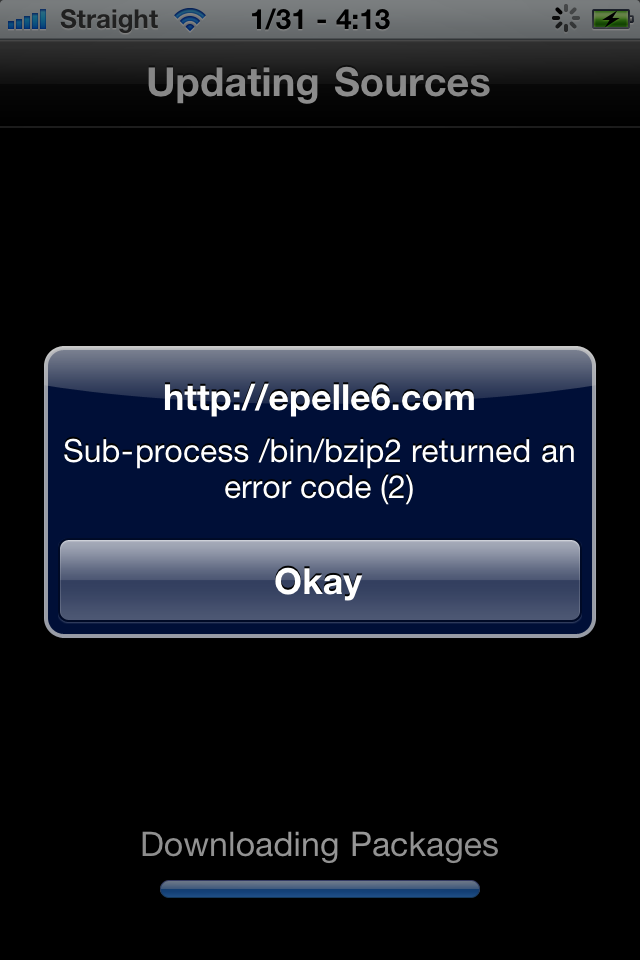

I accidentally added a corrupt repo, and cydia bombed halfway through, now when I go into cydia ALL my packages are blank, and the sources show as blank.
When I do a refresh I get errors galore about epelle.com and xsellize and the old bitsms repo, but yet it's not listed in repos since none are ... is there a way to just go back to only the default Cydia repos and I can just add my extras again?
I tried going in and deleting the corrupt sources from the cydia.x file, the private/var/lib/apt/list/partial directory and the private/var/lib/apt/list directory but the issue is STILL persisting... and now when I try to reload I get Parse Failure and it tries to load the repos I deleted... WTH!?!?! ugh
What do I do?!?!? My insanity is growing, lol
UPDATE: I edited the cydia list file and deleted ALL sources that had been added, and i also deleted ALL packages, and so as far as I can tell there's no evidence of the corrupt crap, yet I then tried to go in and refresh and I didn't get the parse error, but it's still showing that I have no packages installed (even tho I have about 30 installed, things like miwi which works fine, it's just not showing in packages in cydia), and no sources ... so I refresh, nada, so I tried installing source cydia.hackulo.us and I got the attached photo... what's causing it to STILL be trying to get epelle and why are my installed packages not showing? Advice? Give up and cut off my hands at the wrists? :)
