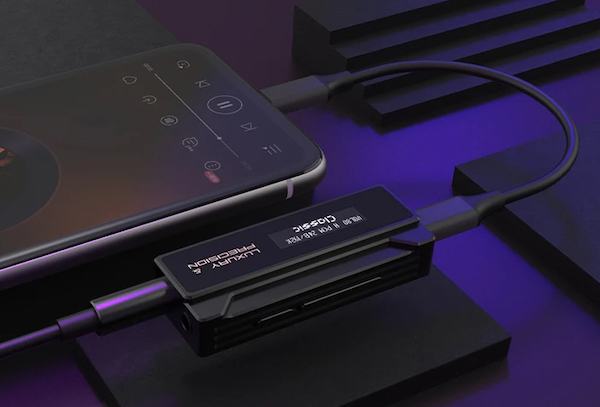

I am totally in the portable game, thus it's all IEMs and earbuds for me. I currently use a USB bus/host device powered DAC/amp for all my IEM/earbud listening with my old 2014 MBP; it's from a company called Luxury & Precision, and the model is the W2. Looks like this:
Over the last couple years, due to portable sources I've opted to buy (digital audio players like the Sony WM1A), I have also transitioned all my cable terminations to 4.4mm balanced. Assuming the W2 works without issue with my yet-to-be-shipped 2021 16" MBP, I'll continue using it. However, I do like reading that many audio enthusiasts are please with the sound output from these new MBPs. I have some single-ended 3.5mm IEMs/buds headed my way to try out, so I'll give the hp outout a shot once I get my new MBP.
