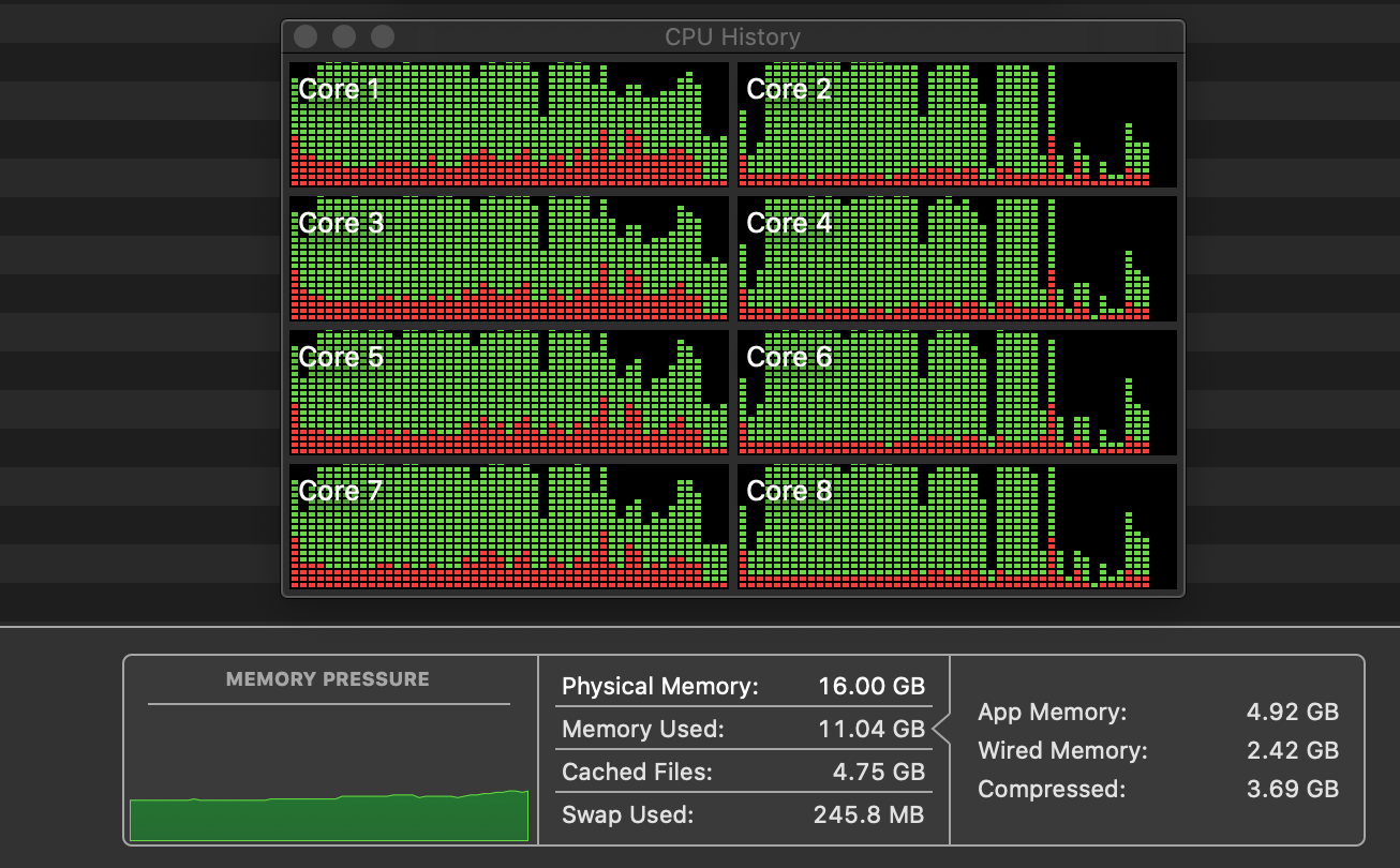

Here's a quick snapshot of what I'm looking like with an Xcode build running + iOS simulator + a few nodeJS services running:
So the cpu is definitely straining. The ram eventually maxes out over time, but it's usually after many successive rebuilds, or having additional apps open.

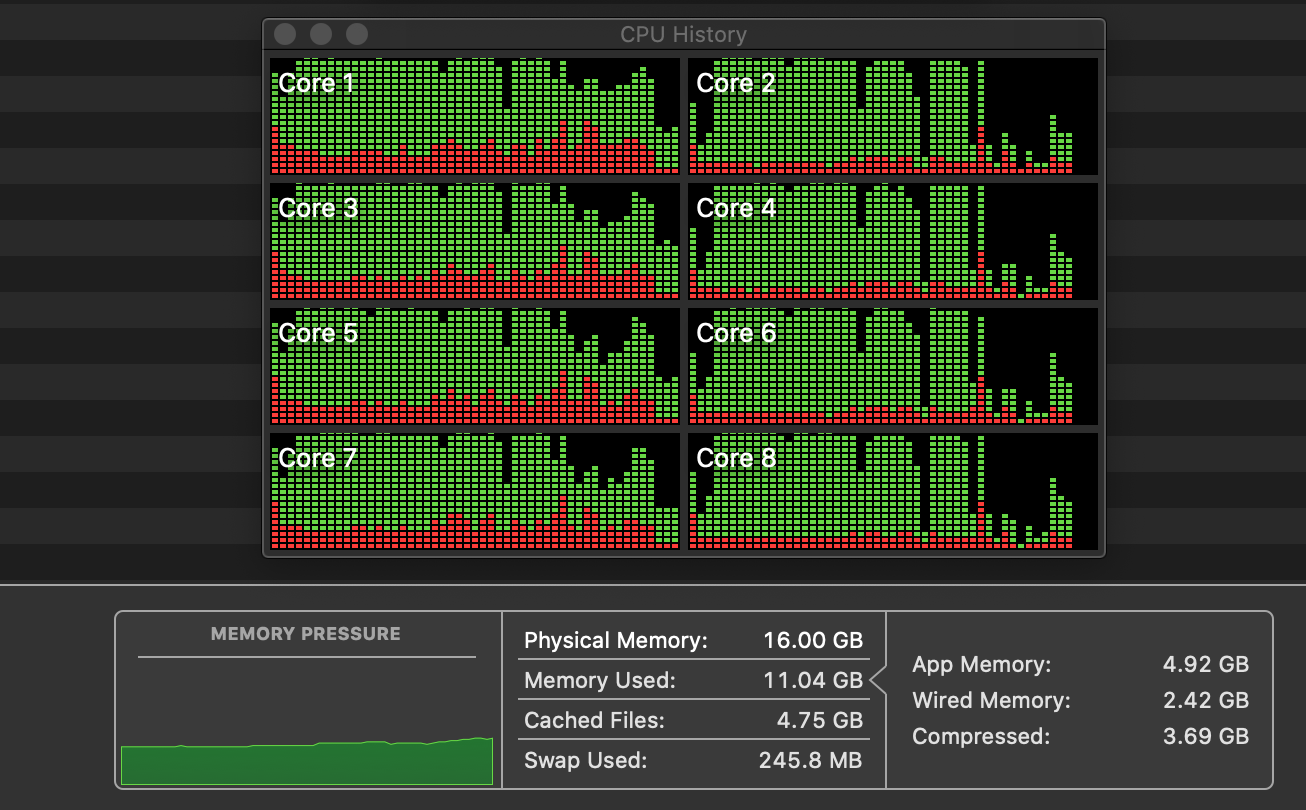

If tossed that workload at a MBP 16" 8 core , 64GB RAM , 1-2TB SSD , 5300M system you'd likely would have lots of head room even if crank you nodeJS sevries up toward your high end number. with the extra RAM could have a Android simulator paused back there also.
That current memory pressure isn't bad but if doubled up the working set data volume it would get bigger. But there isn't much there that screams something for Mac Pro triple digit GB DRAM capacities. The MBP 16" can go 4x on your current set up. There is decently high compressed RAM there so the faster raw RAM in the MBP 16" will help present substantive improvements too. If the subset of RAM wasn't compressed you'd be pretty close to very high memory pressure. ( you're taking an small incremental speed hit to get that compression savings. It is worth it for your combination of 16GB and disk I/O bandwidth caps , but you are closer than the "green light" there makes it look. )
SMT/Hyperthreading is working pretty good there. So the more+faster RAM and faster storage I/O should scale quite well up by 4 real cores (and 8 'activity monitor' cores/threads). Handling double the workload you are now should work at least reasonably well if not much better. Also enough periodic dips in user load there ( coinciding "longer black bars" in CPU graph) , that better Turbo (clock shifting ) is going to get traction also. (better than both the current MBP and the new Mac Pro) . So if mainly training to get "more stuff to run along side this baseline " there is more than substantive traction the MBP 16" can bring.
I suspect the Mac Pro 12 core would just be more head room in many cases. Could tweak compile process to go wider when it could, but if build times are decent now if just drop "extra stuff" how much can bring times lower by going wider depends upon the code. Long sequential dependencies on builds are limited. Or perhaps the Android simulator is a bigger hog. :)
