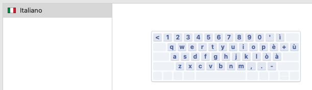

Apart this I think that's something wrong with the italian layout:

This is the layout in system preferences on big sur 11.4:
Why the less than next to 1????
My god...why do they touch the keyboard layouts???

The image of the layout in system preferences is still wrong.
