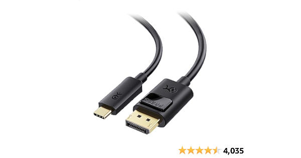

I'm not familiar with the mentioned monitor. Have you tried using two displayport to USb-C DP cables directly connecting to the computer like one I linked below:
Theoretically pair of that cable should work? But I'm not really sure how two dp 8k 60hz output is implemented by Dell.
Otherwise, if you have to use a TB3 converter between machine and monitor, it may not work. If all don't work, the best choice may be to get a graphic card with two dp output. All my theories are based on an assumption that Catalina supports 8k 60hZ
