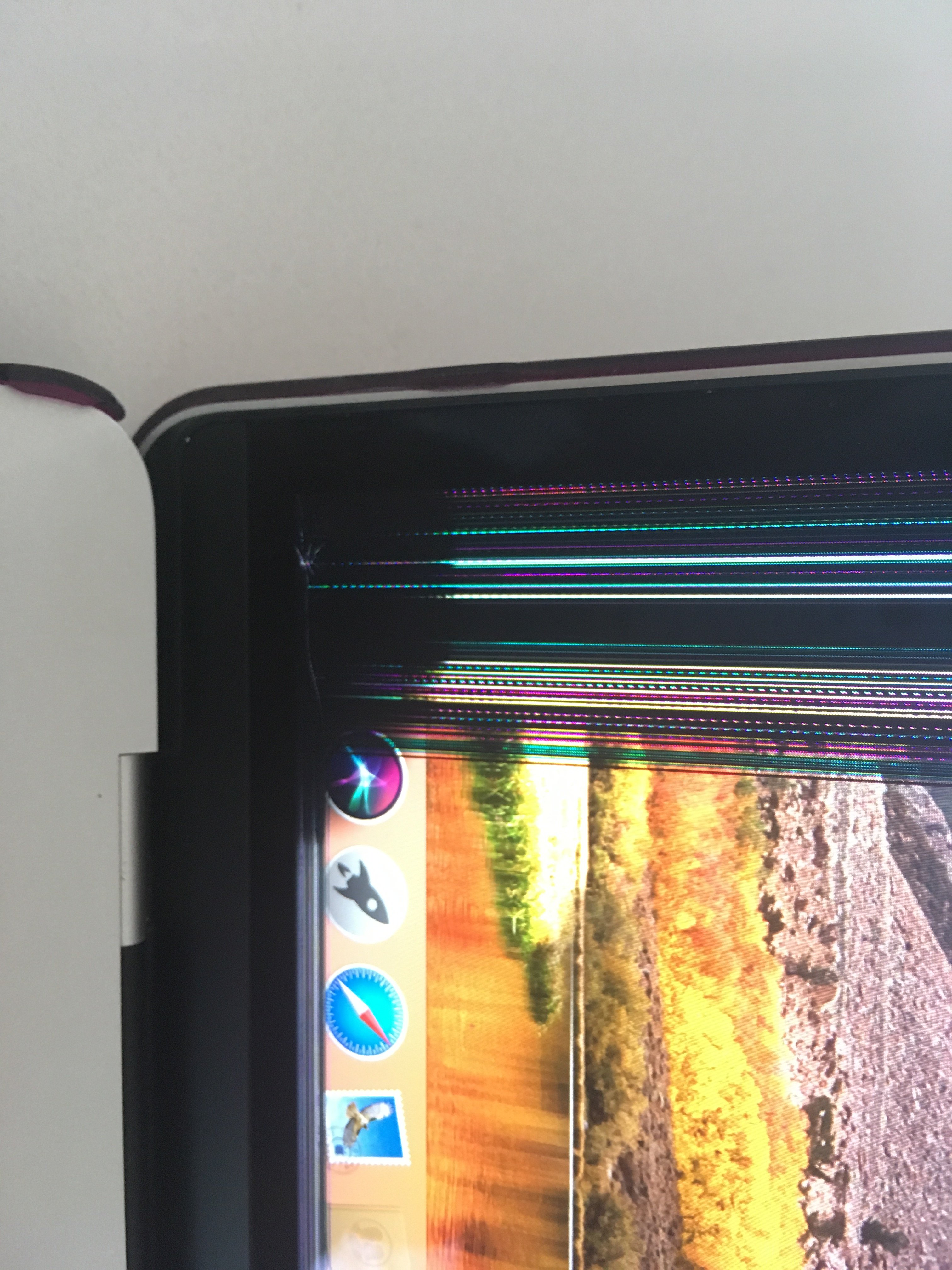

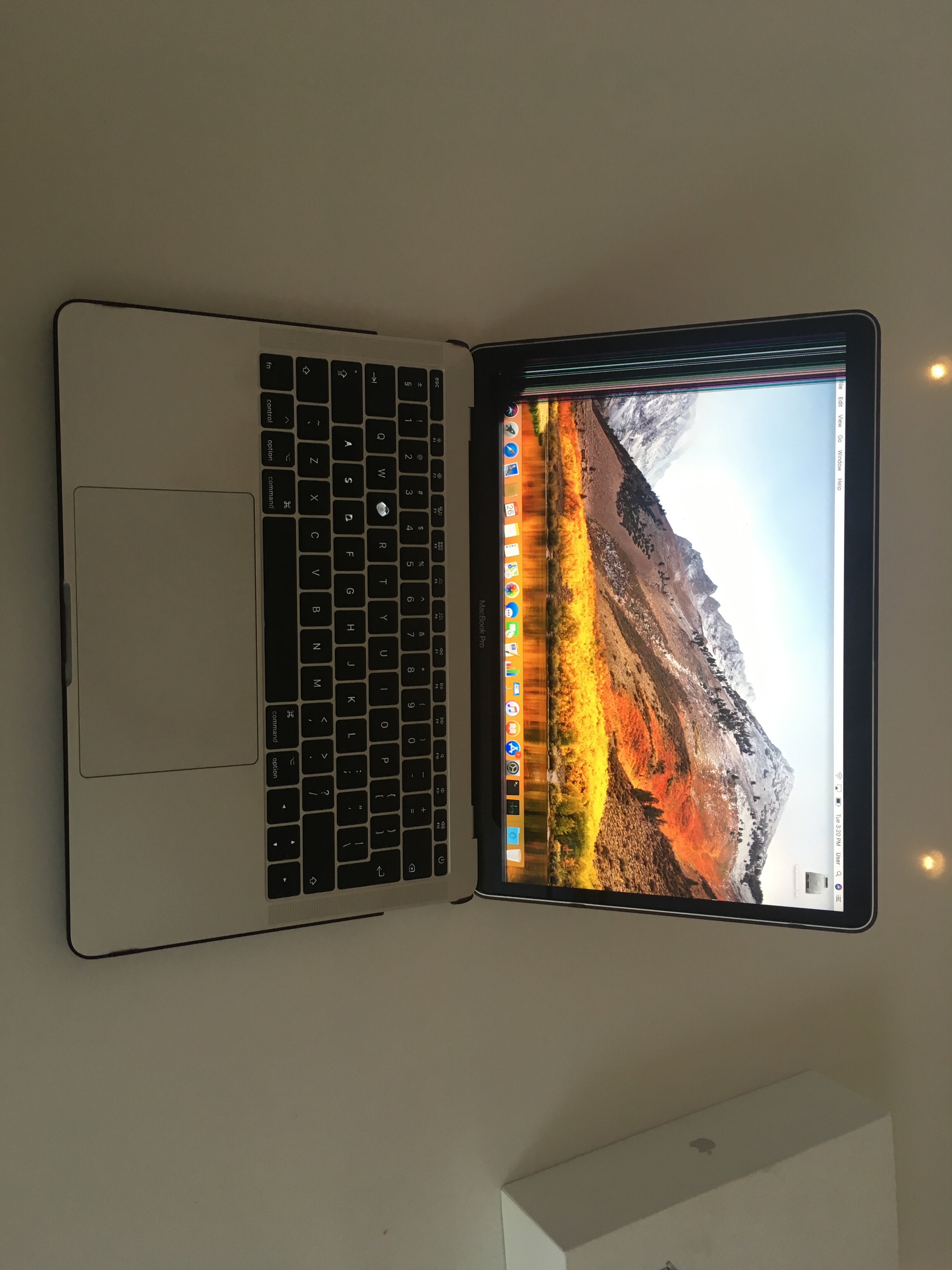

Hi All,
So to cut a long (and horrifying) story short. My MPB A1708 miraculously developed a pin point crack in the lower left screen and damaged the LCD. How this happened, I am unsure as I keep my MBP in a hardshell and in another neoprene case. Perhaps it was a grain of sand or Antman but both are unlikely because the point of damage is over my "esc" key. Either way, I'm almost sure Apple will classify this as accidental damage and it won't be covered by my warranty (we don't have AppleCare+ in South Africa).
What is weird is that if I leave my MBP turned off for a couple hours my screen turns on albeit there is a +- 3cm blacked out vertical line on the left side. I am happy to work this way for the next 20 years as I save to get it repaired but the issue is that when I turn it off again, the screen won't come on for hours. It does however, work well connected to a monitor. I have reset my SMC and PRAM etc. but that doesn't do it.
My desperate plea for advice is then two-fold. First, is there a way to determine how the MBP is booting my screen up even when slightly damaged and replicate that on demand? Perhaps via terminal? Second, I have not gone to Apple yet to see if they could cover it whilst I'm still within my first year of warranty. The MBP has not seen a second of misuse or impacts and is in brand new condition so its really frustrating that something could sneak past both my layers of protection and render my MBP useless. Do I have a shot talking to a genius? Any tips? Please help tech geniuses...

Haha @Ma2k5 perhaps I'll look into keeping it in a display vault for its foreseeable future. Thanks for the advice. I'm going to take it in this weekend, get it diagnosed and plead my case. I see from other threads that I am not alone so perhaps they'll be understanding. I will keep you updated. You'll notice in my picture that the keys are also wearing thin after a year of typing... its not looking good for this poor laptop. Hopefully they'll cave and at least fix that. Thanks again.

I can tell that your MacBook is well cared for - unfortunately, you can see the point of impact in the bottom left corner (not saying you necessarily dropped it or were aware of the problem when it happened). In my opinion, you were most likely using the laptop and at some point something small and hard like a pebble or something of the sort made its way onto your laptop near that part of the screen. Without being aware it was there, you closed the laptop lid and that generated the "point of impact" causing the screen to crack.
I used to deal with ADH cases when I was a technician, and the first thing we look for is the point of impact - which in your case is quite small. If I were you, I would go to an Apple genius and tell them thats how it happened or how you suspect it happened. It's quite unfortunate because it seems your not at fault here - but unfortunately, a repair tech is going to tell you that its a repair you need to pay for. Hopefully they at least give you a break on the price. Best of luck

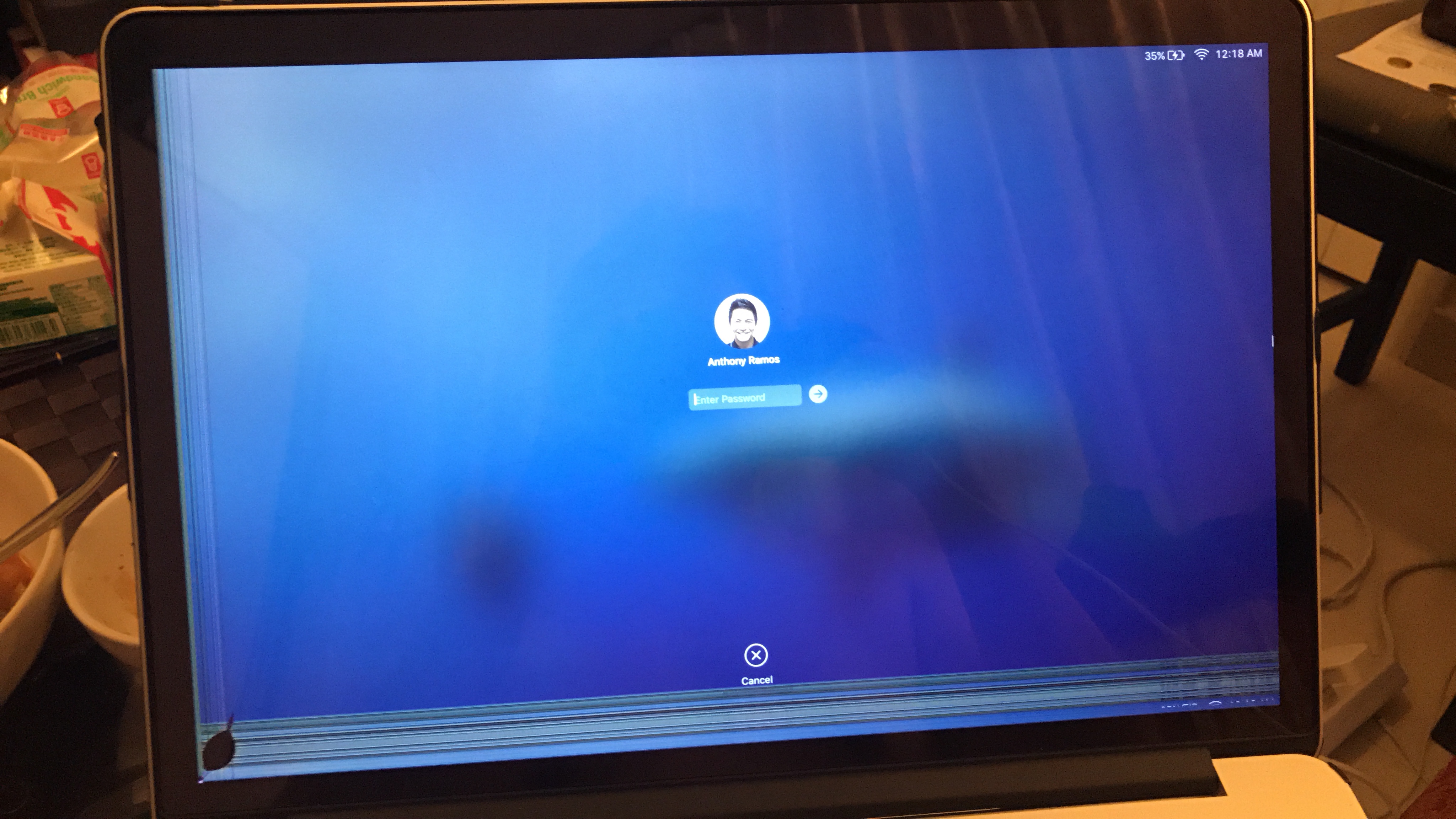

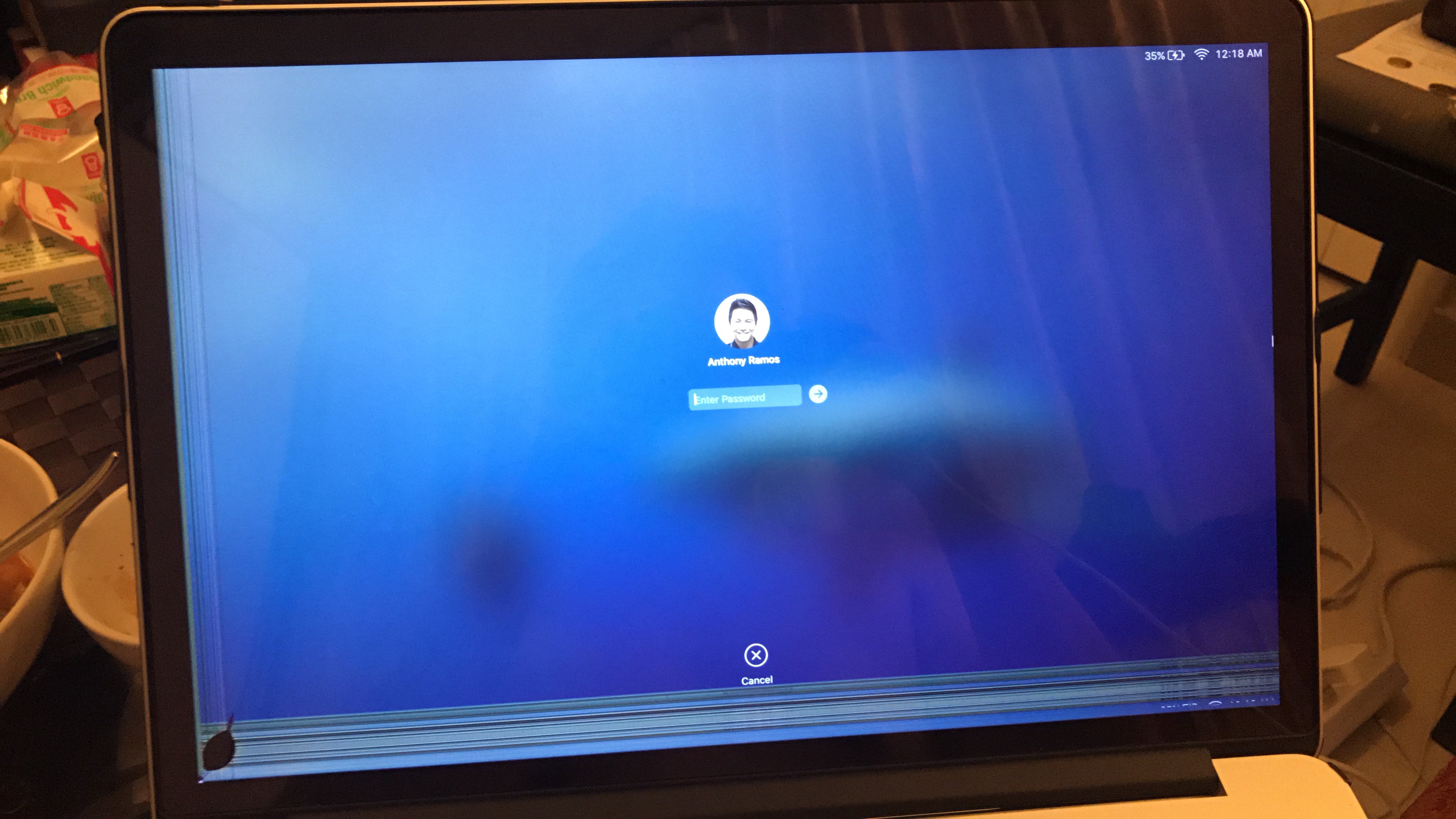

Congrats! Similar thing happened with my old 2014 MacBook Pro and they too replaced it for free. They said this happens once in a while because the screens are so thin.
@Rafterman good one :D
@mr.anthonyramos Thanks, the damage to your screen looks rather similar. You hear of some horror stories and quite a bit of hate for Apple on the forums but I had a really pleasant experience. It went through an authorised reseller and still only took 5 working days and I was kept in the loop the whole time.
