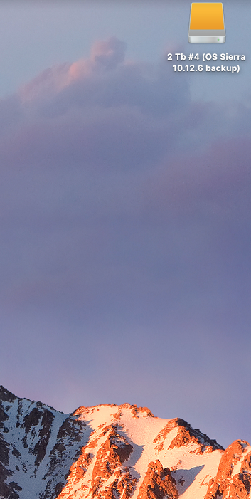

There's the screen shot...you see all that empty blue space....that's where the internal disk images should be.
But disk utility (opened from the external drive backup) shows they are there...

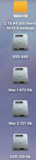

The finder icon shows most of them, but not the SSD 480, which is the startup disk....the "WDC WD10EACS" IS invisible--I made it that way years ago. So that's OK.

Okay, it’s definitely not a MacBook Pro lol. Completely misunderstood the original issue.
OP: when you’re in Finder (click your Desktop) press “Finder” at the top left (next to the Apple logo) and select Preferences.
Tick the option for “hard disks” where it says “show these items on desktop”.
Yep. It figures. Something any idiot would know...but I didn't. Click the box, they appear magically. Thank you!
