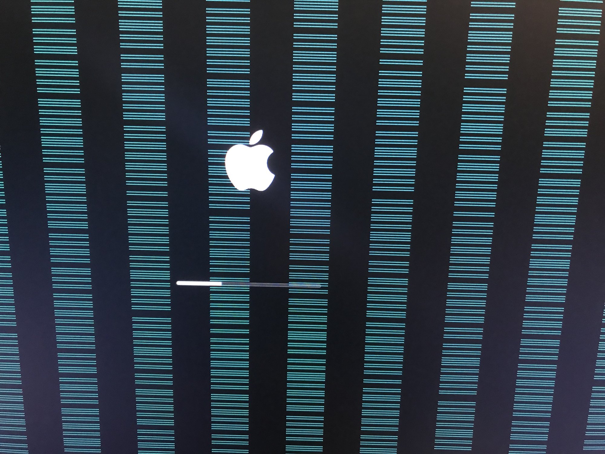

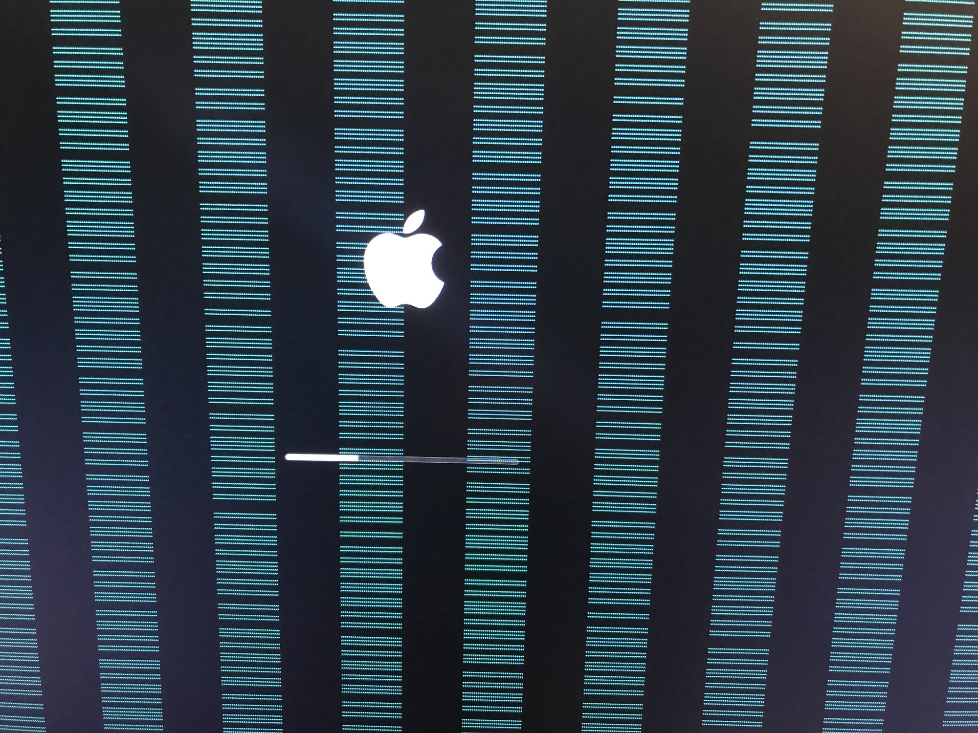

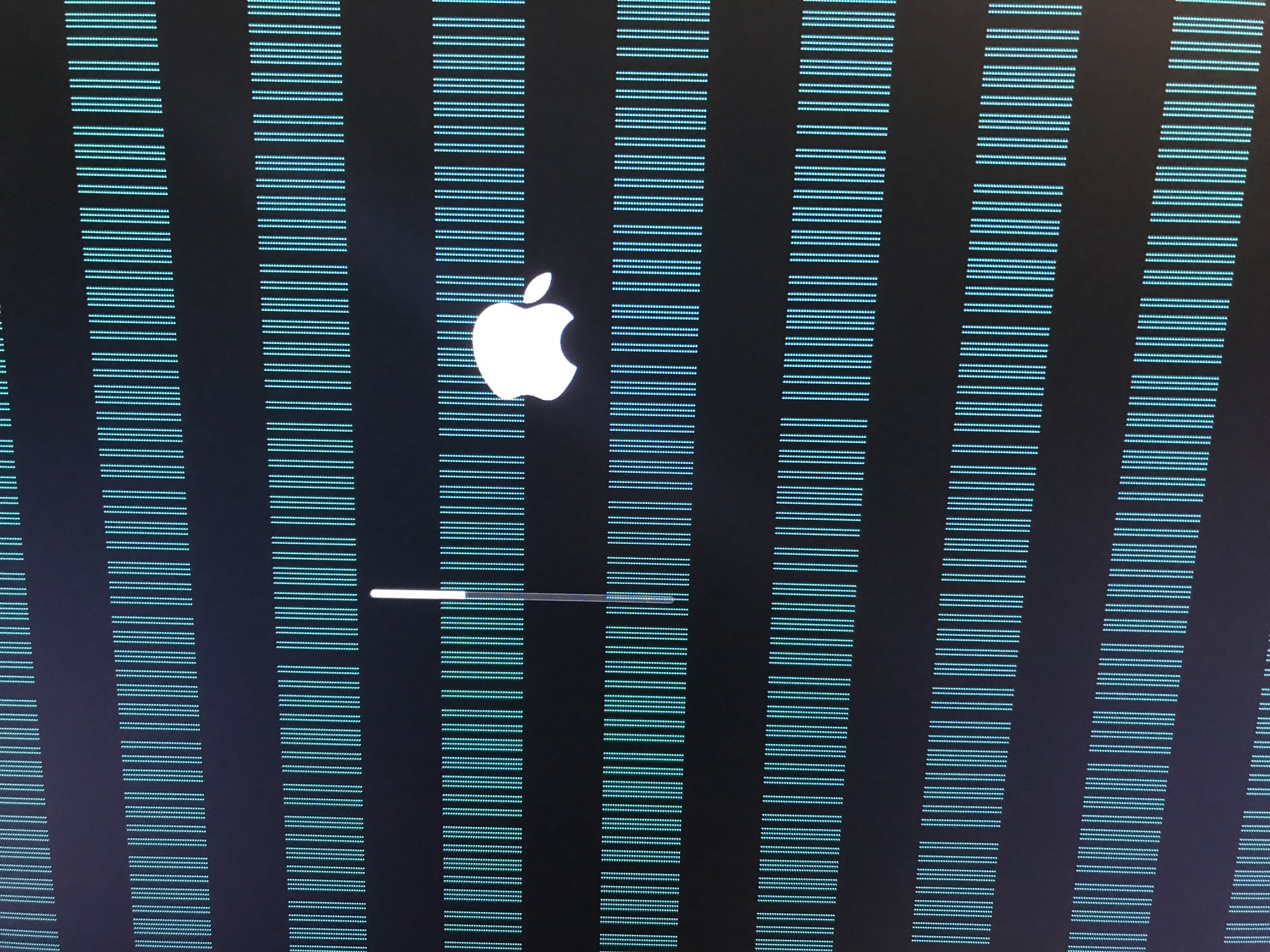

My son was working on a doc on my old MP6,1 when it crashed with a purple screen. Trying to reboot it, it hangs with the progress bar one third of the way through. Display is also partly corrupted.
I tried entering the recovery mode or resetting the NVRAM but I always end up with the same behaviour (hanging on boot screen).
Did it just turn into a pretty paperweight?
Looks like a graphics card error to me.. Have you tried resetting SMC and all that good stuff?
Yep, no result at all. Even the diagnostic (D at startup) did not work. Luckily the target mode would work, I managed to salvage my son’s doc which he needed to submit to university tonight.
As someone else mentioned....it looks like graphics card problem. If so, it might be prohibitively too expensive to replace it.
Maybe, it's time for a new Mac!?
Good luck with the entire situation.
richmlow
you can try taking the cover off and giving it a good clean, they can trap a lot of dust inside. I had a problem with a stick of RAM not working in a Mac Pro 5.1 and it turned out a bit of dust was shorting out the pins.
As Macguru said, spare parts for the 6.1 are very expensive and troubleshooting is not that easy.
