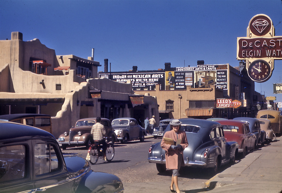

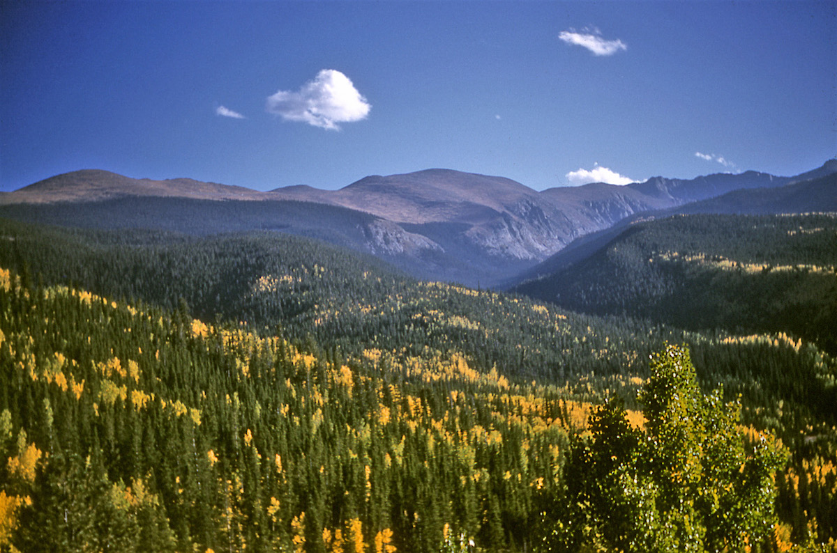

Digitized many of my Mom's old slides including these three. Used a now ancient Epson 2450 scanner and scanned at 1200ppi. Yes it can be time consuming and the results will very much depend on how good the slide is. A micro-fibre cloth for cleaning glasses was invaluable for removing dust just before scanning. Even so there was always a spec or two that needed additional attention. A few samples, all were from Kodachrome and have been slightly reduced in size from the original scan. Very slight sharpening in Preview as well. From 1953, 1949, and 1965 respectively.
