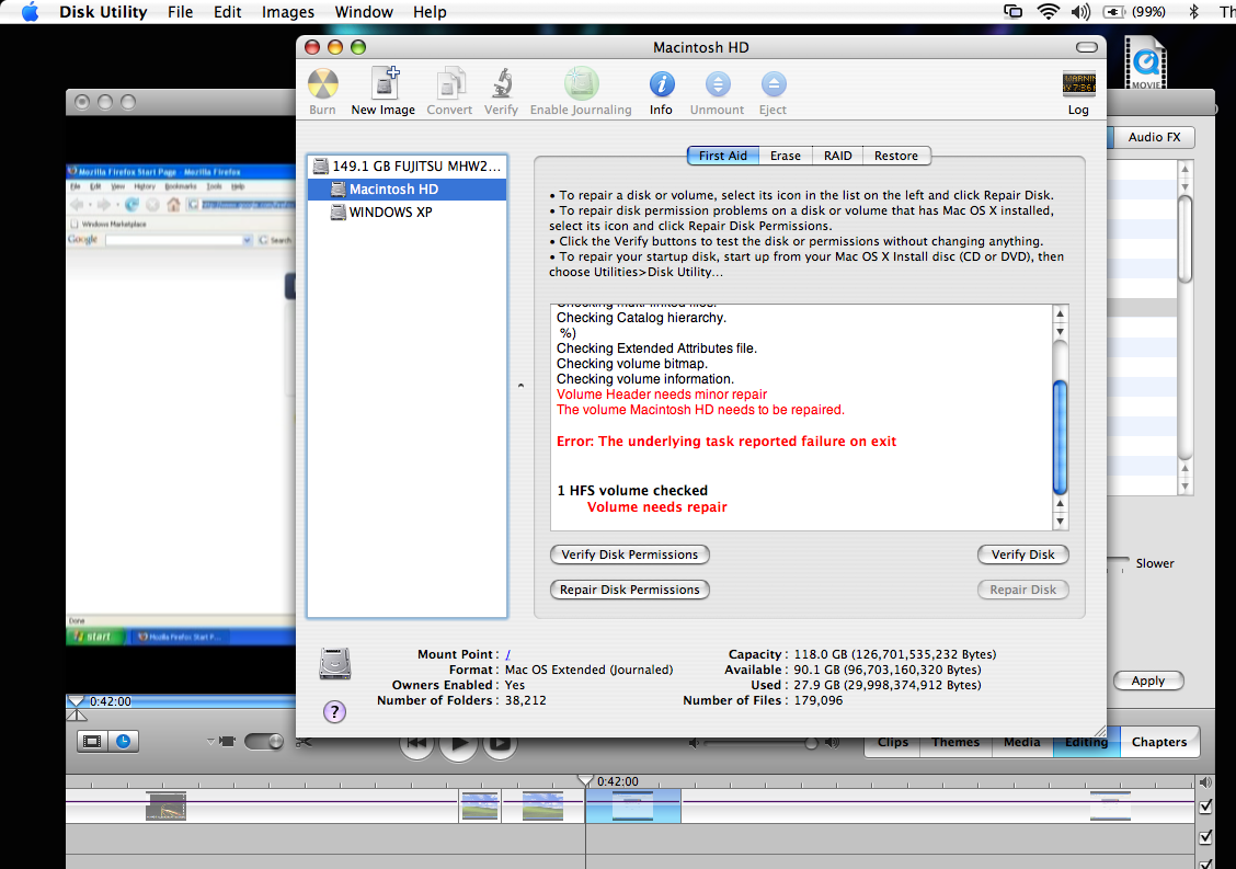

okay so today i was normally doing some video editing for a movie i was going to put on youtube, and i wanted to add a transition. when i tried to add the transition a dialog box opened up saying i couldn't, unknown error, try saving and reopening. So i go to save my movie and after i click save a message comes up saying "the disk might be locked, read only, or completely full. Try saving from a diff location, i go to save to a diff location, same dialog.
So i go open up disk utility, i veryify my disk and sure enough my disk needs repairing. (see attachment) When i try to click repair disk i cant, its not highlighted, i have no idea what to do, am very upset because its pretty new.

You can't repair the startup volume while booted to it.
Boot off another volume, or use your OS-X "restore" disk (hold down "c" when starting up to boot off CD/DVD). When you get to the "install" dialog, you will see menus are enabled and you can run Disk Utility from there.
edit: read the info in the bottom bullet in the Disk Utility dialog (the screenshot you attached)
Ha, I see you've got the double arrows at both ends "secret feature" enabled. But you can't do anything to something that's running without encountering problems... like dragging the system files to the trash. just boot from the install/restore disks and open up disk utility on that... don't install anything.

Ok i loaded in the cd and everything worked great, i wasnt expecting a real UI but anyhoo i believe its all better now, except for the fact i lost my movie i had spent a good 30 mins on. o well
