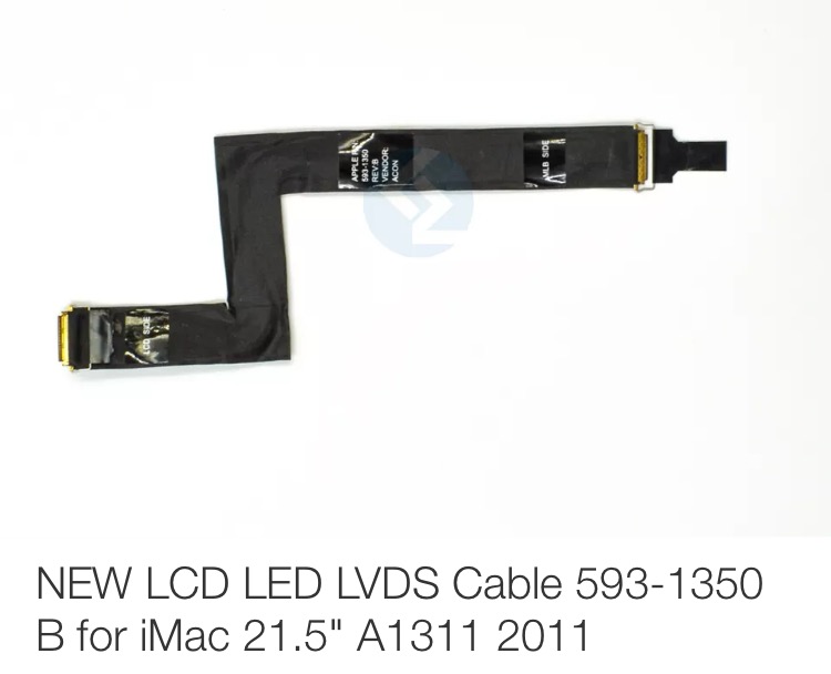

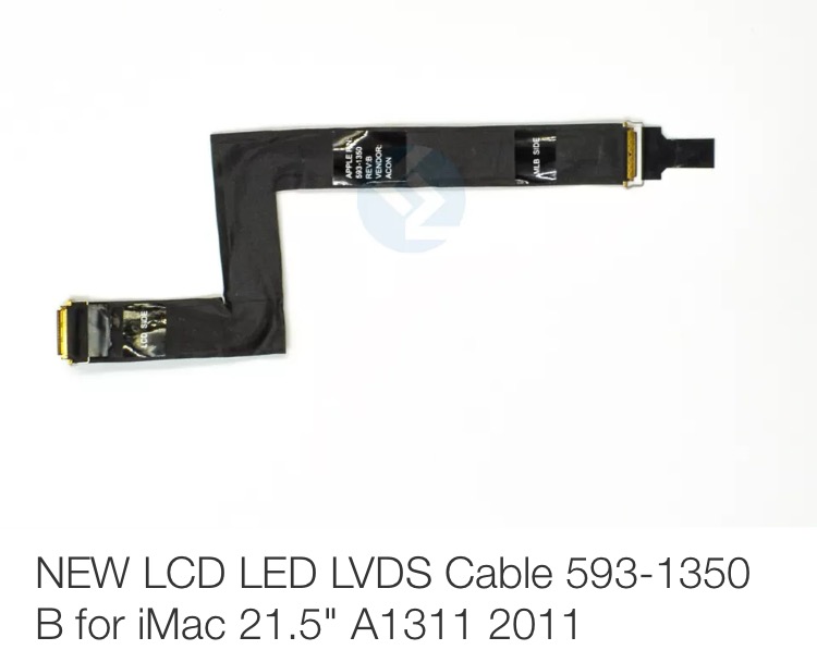

I changed my HDD on my iMac and decided to install the thermo sensor after awhile. Machine was working fine, it's just sometimes it made little noises, so I decided to fix that. So I torn machine down again, installed the sensor, put everything back together. And... It turns on and display is not working - black screen. I went inside again, found that display data connector (the wide one) is damaged. I went to a store, bought a new connector (this is how it looks)

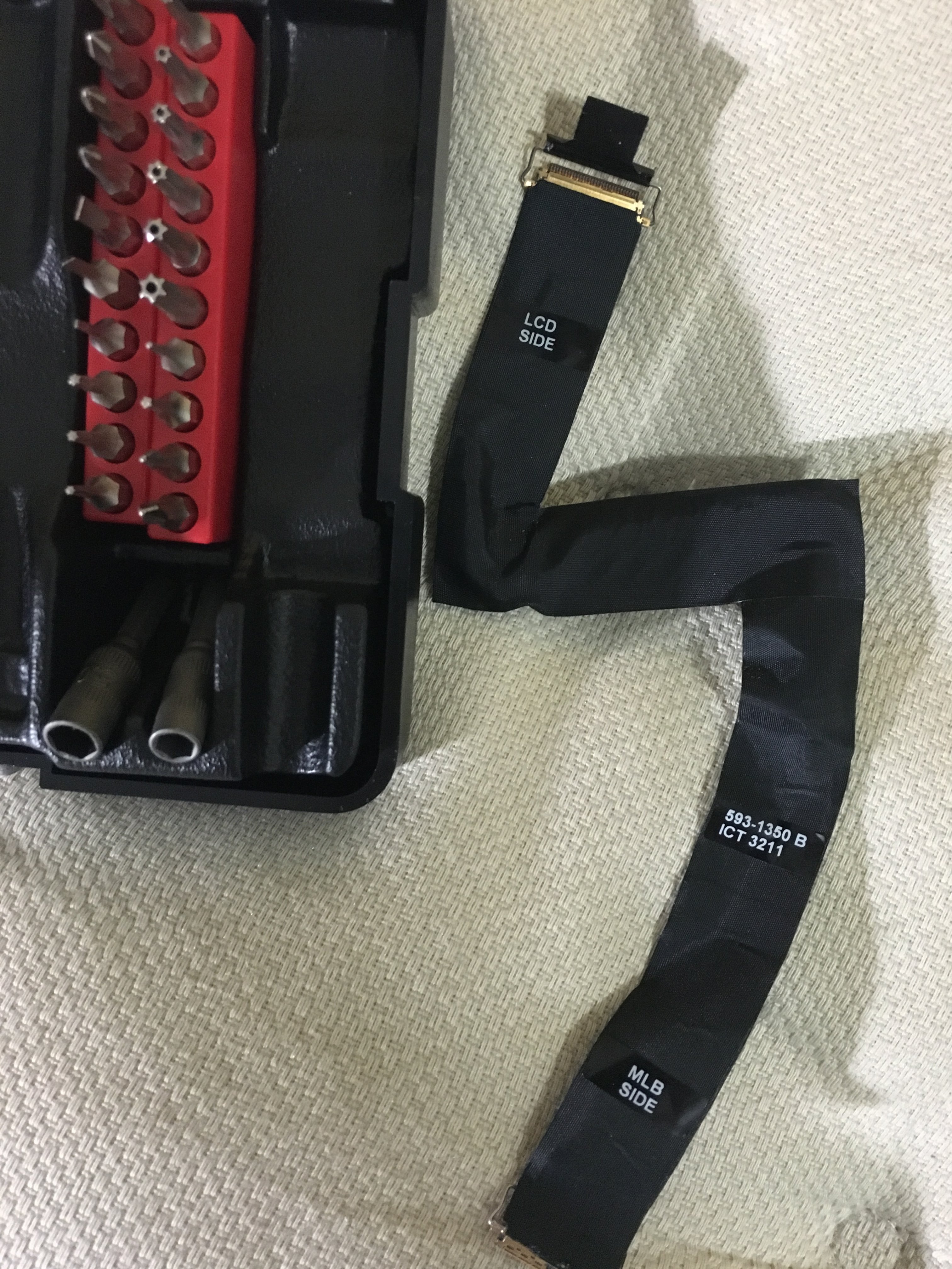

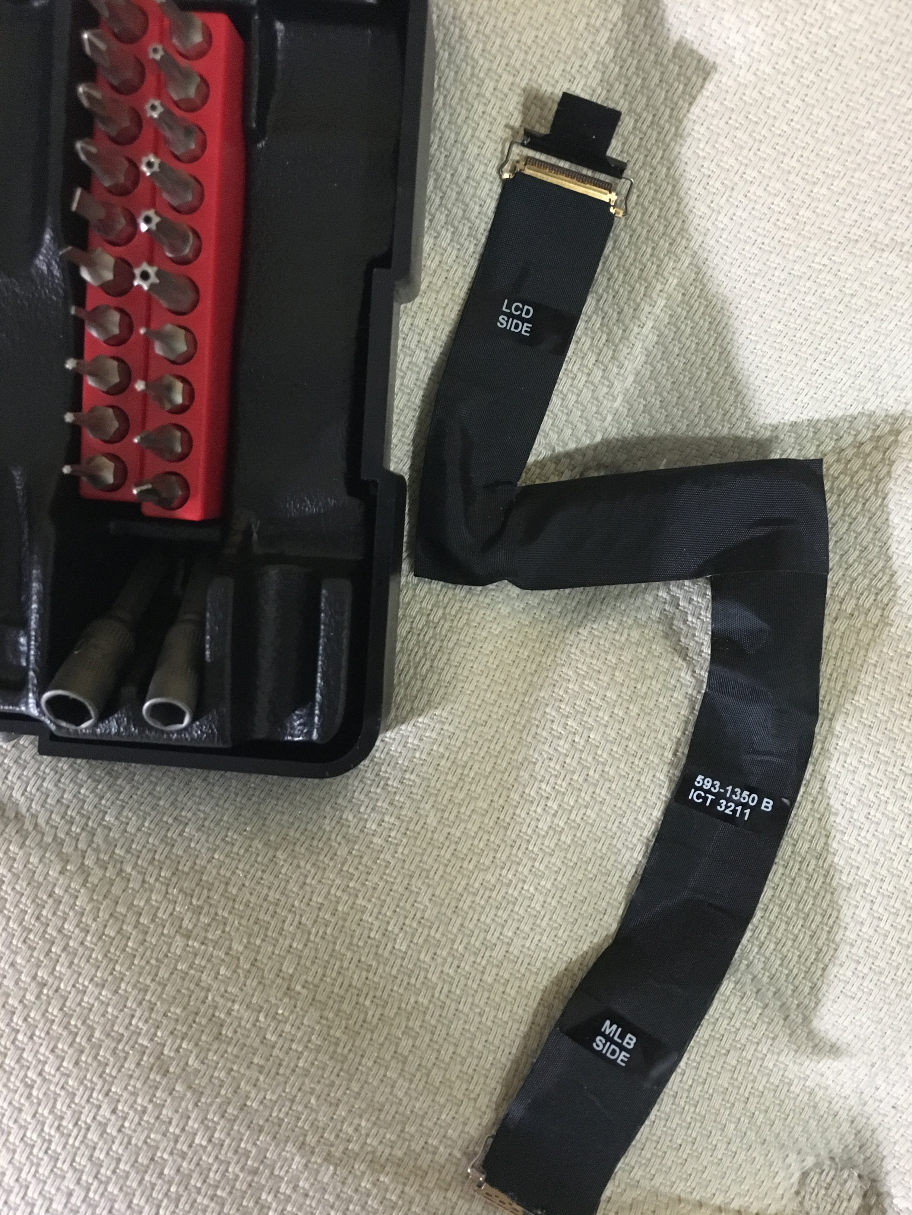

, put it on hoping that it was gonna work this time, but the screen is off again. Double checked all the connectors - everything is plugged in. Then, I've noticed that my old connector is having a little bit different ICT number than the new one that I bought. The old connector: 593-1350 B ICT 3211, the new one: 593-1350 B ICT 3112. I checked everything, dunno if it's motherboard, display, video card, or just because the connector is not matching. My question:
What do you think should I do guys? Any smart suggestions and your experience is needed. If this difference of ICTs might be affecting the display on the computer that it is still not turning on?
Old connector:
