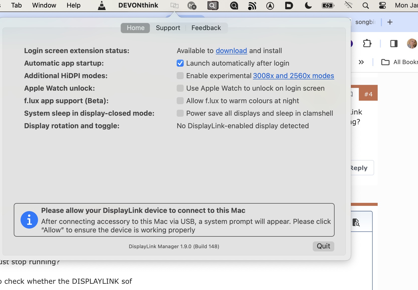

The external monitor / DisplayLink is no longer working.
It was working fine until I turned it off (while the rest of the system was running). Then, when I turned it back on, it has not received the signal from the system, it keeps giving me the "no input" message, even though the power is on and everything is connected as before. So I haven't gotten it to work in a few wethe eks now.
The DisplayLink software appears to be working, I'm still getting the manager at the
(By the way, the DisplayLink community forum is useless - for some reason, it won't even let me post an inquiry.)
Grateful for any suggestions. I thought to un-install the DisplayLink software and then reinstall, but I haven't tried that yet.

Is your monitor set to the correct input? If you're using an HDMI cable, is it on the HDMI input; or if you're using a DisplayPort cable (not to be confused with DisplayLink), is it on the DisplayPort input?
Does the "broken" monitor work if you swap them around? (To make sure it's not dead.)
Does the DisplayLink software still have the "Screen Recording & System Audio" permissions found under System Settings -> Privacy & Security? It needs this permission in order to work.
WF: Yes, I turn it off and on, and the brand name flashes on the screen, indicating that the unit is still functioning. Also, I try switching around the inputs, and it still doesn't do anything.
WF: that I haven't tried! thanks!
WF: yes, I just looked in the settings, it's still turned on. Thanks for suggesting that!
