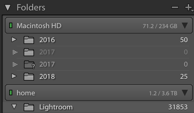

I import photos into my local library and then work on them. Then once done I can just drag them (inside LightRoom) from one library to the other. Just a literal drag and drop from one to the other, from inside LR.
In LightRoom I have two folders, one is created locally and the second is a folder structure on the NAS.
I have my catalog and cache on my local drive.
It's not completely seamless. Sometimes, like this morning, if I open LR and the network hasn't reconnected the "home" folders show with a "?" next to them and I can only view previews that exist in my local cache. Like how the 2017 folder appears above. I guess I killed that particular 2017 folder in Finder and not LR. When that happens I just connect my network drive and everything works.
The whole thing works surprisingly well.
I have a RAID setup on the NAS, and then every month I also backup the NAS volume to an external disk.
