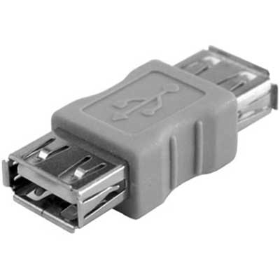

I have this idea that If you take the supplied USB to dock cable, purchase a female-to-female USB connector you will be able to connect any usb device without having to purchase anything extra. Would this work?
iPad > Dock-USB > USB-FEMALE/FEMALE > Any device!

Essentially he's trying to avoid buying the camera connection kit which provides a female usb to dock connector. Would be interesting to find out if that is the way it works, or if apple includes some kind of verification chip in the circuitry of the camera kit.

I can confirm that this does not work (and thankfully the iPad lived). I am guessing that the camera connection kit is like other ipod/iphone accessories, which use a resistor between pin 21 and ground (pin 15 I think) to tell the device what to do with its usb line. Problem is, the kit is so new that no one has taken a multimeter to the pins to figure out if this is the case and if so, what the right resistance is. So basically Apple isn't charging you $30 for a F<>F USB adapter (along with the same, routed to an SD card slot), but $30 for a F<>F USB adapter and a <1 cent resistor, which is still kind of a ripoff really. It would be lovely if someone who has access to the kit would test my hypothesis, otherwise I will be able to do so next week. I highly doubt that apple has anything more complex than that in the thing (like a chip or IC), but I suppose it is possible if they really wanted to be jerks and stop people from making their own. Hope that helps, I'll post here again if I find anything more.
EDIT: Another possibility is that the iPad uses some of the other pins in a creative new way, for instance those formerly used for firewire... I dunno, someone might have to sacrifice a CCK to science :rolleyes:

Makes sense to me. I guess we'll have to wait and find out. I already ordered a F<>F USB adapter from ebay .99 cents. If I need to rewire some thats fine. I figured they wouldn't make it super easy.

Yeah, it sounds like a pain... you would need to crack the case off of a dock cable (which would need pins in the right places, which is another question), add the resistor, and then chain it to the F-F adapter. I guess it is just a question of whether or not your time spent is worth more or less than $30.
As for the iPod camera connector, it has been confirmed that this does not work. My guess is that it is identical, save for that one pesky resistor! Voodoo... :mad:
It's also entirely possible that software to drive the usb interface is actually loaded from the adapter itself.

The old iPod camera kit does not work on the iPad. The iPad and the new camera kit have chips in them that ensures you must buy Apple approved accessories. Just like the video kit.

I think there is more than one chip in it, and that the camera kit IS the host (not the iPad),
and provides a simpler connection between the camera kit & iPad.
