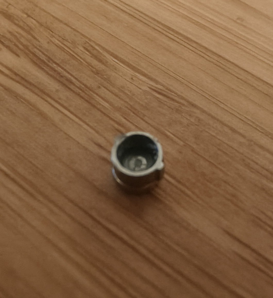

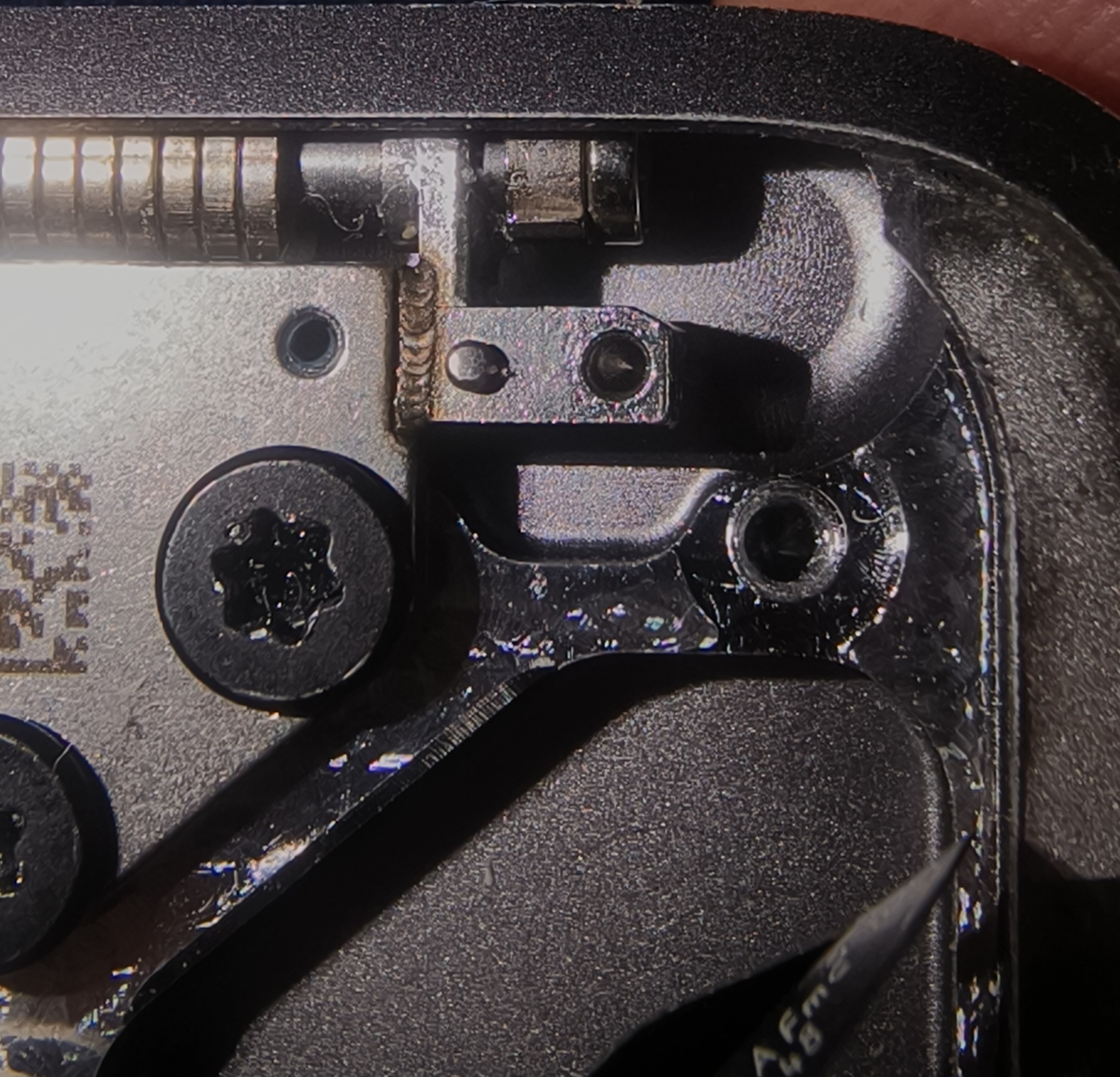

But, there is an easier solution, requiring about 1 hour of time and proper hands - Just change the magnet on hinge. Attach your old magnet to your new hinge.
The magnet is actually glued to the hinge, just give it some angle moment (small ledge on the magnet will help you) and it will rotate, then can be easily removed.
Put small amount of super glue inside the magnet and reattach it to your new lid/hinge. NOTE: direction of the arrow on the magnet should be exactly same as it was on your old hinge, usually arrow point right down the lid, parallel to the lid. +-5° is ok.
The magnet has no load on it, so super glue or epoxy should be ok.
This worked for me on A2141:
