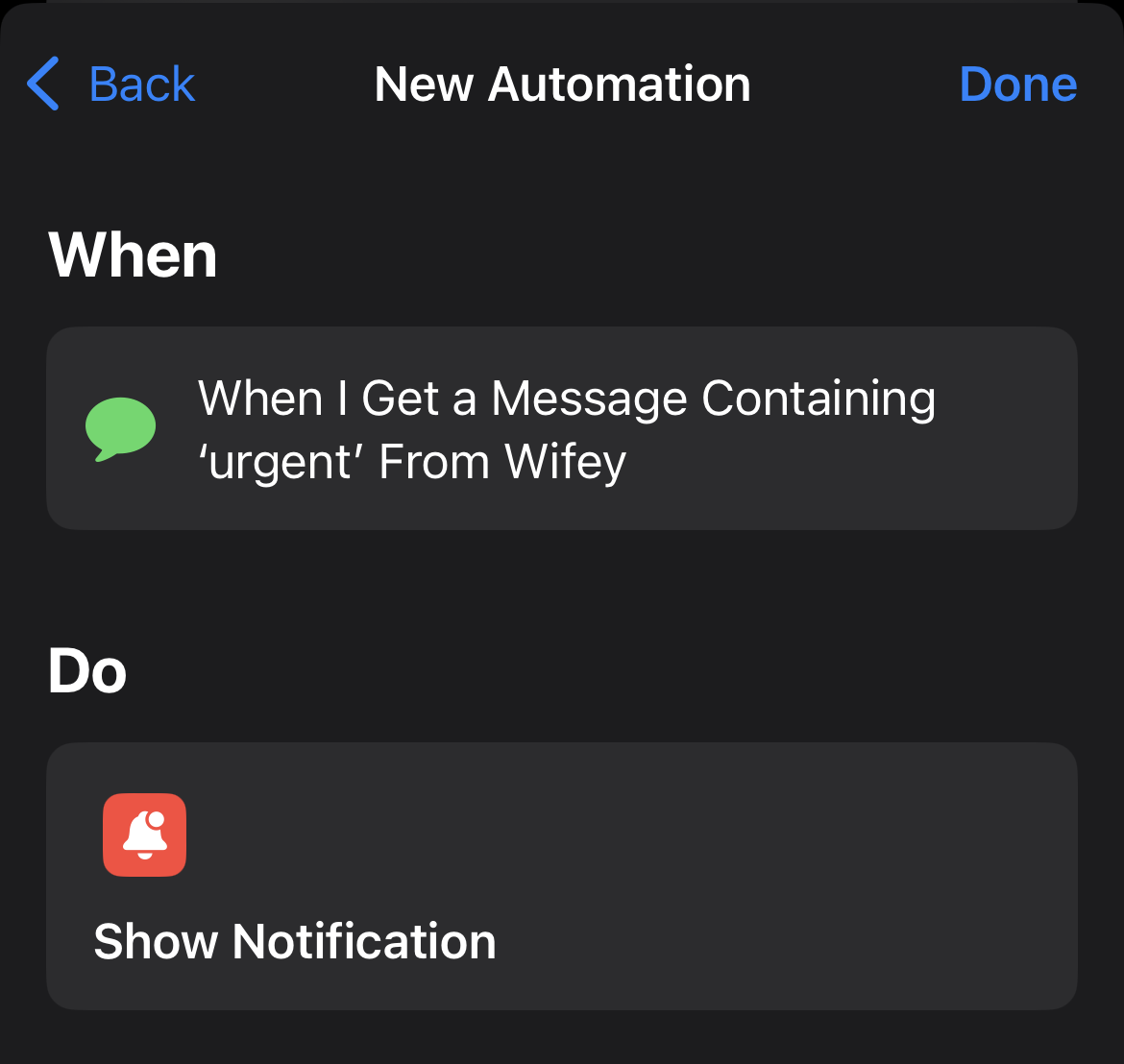

Haven't tried this myself, but I think you could do what you're looking for via Personal Automations in the Shortcuts app.

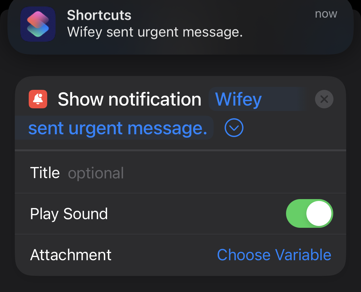

In the Shortcuts app, create a personal automation "When I Get a Message Containing 'urgent' From Wifey", Do Show Notification. The notification would be some static text you entered, such as "Wifey sent urgent message". You would also likely need to update your "Do Not Disturb" focus mode to allow notifications from the Shortcuts app.
There are other actions you could use instead, like 'Vibrate device', but I think that would be easier to miss if you didn't have the phone on you. (The 'Show Notification' action will also vibrate your phone if you have it play sound.)
View attachment 2250255 View attachment 2250260
If you happen to have other Shortcuts with notifications that you don't want to break through the Do Not Disturb mode, instead of allowing the app, you could have an action to turn Do Not Disturb off before showing the notification.
Thank you for the thorough and helpful response! I did what you instructed and screenshotted from above. This is pretty close to a solution! Unfortunately it looks like Shortcuts isn't an app option to allow notifications from in Focus mode though.
I did some poking around with this out of curiosity. Looks like you don't actually have to whitelist the Shortcuts app. Notifications from that app will come through when Do Not Disturb is on.
However, it still didn't quite work like I thought it would. Instead of showing your custom notification right away, it shows a notification from the Shortcuts app letting you know it wants to run an action. Once you confirm/run it, the actions are then performed.
With that in mind, you could probably tweak the automation. Instead of doing the 'Show Notification' action, you could do 'Open App' and have it open Messages. Now when you get an urgent message, you'd get a notification from Shortcuts letting you know it wants to run something (this would be your indication that an urgent message came through), tapping/running that will take you right to the Messages app.
Also, you don't necessarily have to pick a sender in the when clause. You can just have it apply to all messages that contain 'urgent' in case you wanted others to be able to break through and reach you as well (i.e. friends, co-workers, boss, etc).
