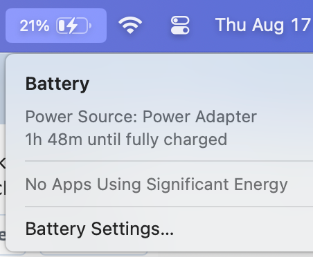

I don't know for certain, but I would assume that if your Mac says "Power Source: Power Adapter", that anything being powered by the USB ports is coming from the power adapter as well.
