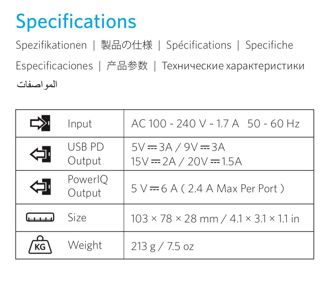

What Anker charger do you have?
Ive got the PowerPort Speed PD 5.
Here are the specifications:
