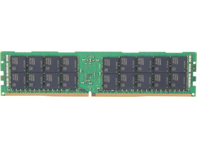

After waiting and saving for years, I ordered a 16 core Mac Pro with the stock 32 GB RAM so I can upgrade it myself. I know the Mac Pro supports either RDIMM or LR-DIMM, but not a mix of both. I also know that Apple ships 384 GB RAM with LR-DIMM and anything below with RDIMM. I was just reading a blog at OWC and it vaguely implied that the Mac Pro doesn’t support 64 or 128 GB RDIMM. Does anyone know if this is true? Also, if it is supported, is there a performance hit from using 6 x 64 GB RDIMM as opposed to LR-DIMM?
thanks!
It would be 6 of these:
