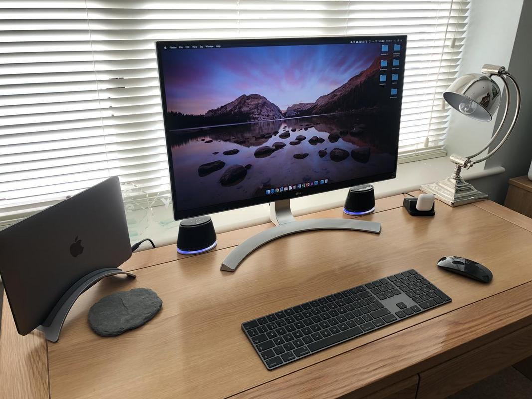

Exactly what I do with the LG 4k. Single USB-C cable does everything. Got the space grey keyboard and mouse to match everything up.
So you have one cable going from your MacBook Pro to th LG display and it powers the display and does audio/video out at 4k@60hz?
How would you achieve this with a 2015 MacBook Pro? Can you use one cable and to this on that machine?
Yes one cable does it all, very neat. It’s only the 2016 models and above I think. Needs USB-C.
The speakers plug into the monitor as well.
Yep, I just charge them on it when I’m using my phone.
Want to upgrade my monitor to the 32” version now lol
I wish I could afford one of those! I have two 32 inch Samsungs (just plain 1080), so I would have to spend double on my setup if I upgrade the monitors.
And, I must say, super nice setup overall! Wish my desk setup looked that sharp!
