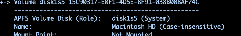

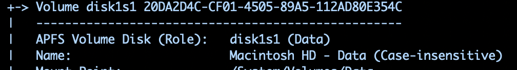

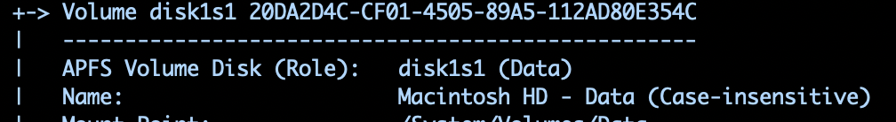

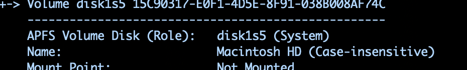

That’s probably because, with APFS, the installer creates various new volumes to hold the MacOS install (it’s now a lot more involved than just a System folder)
This.
Do a "diskutil apfs list" and see, for example, the roles that get assigned to volumes, to tag what they are for. So can't just make a volume and good to go these days.
Another example of this is Time Machine volumes. If you create an encrypted volume for TM, TM will wipe it out and create a whole new one with a role of Backup.
So, at install, the pre-made volumes are not "correct" for the installer, so it's going to "fix the problem".
